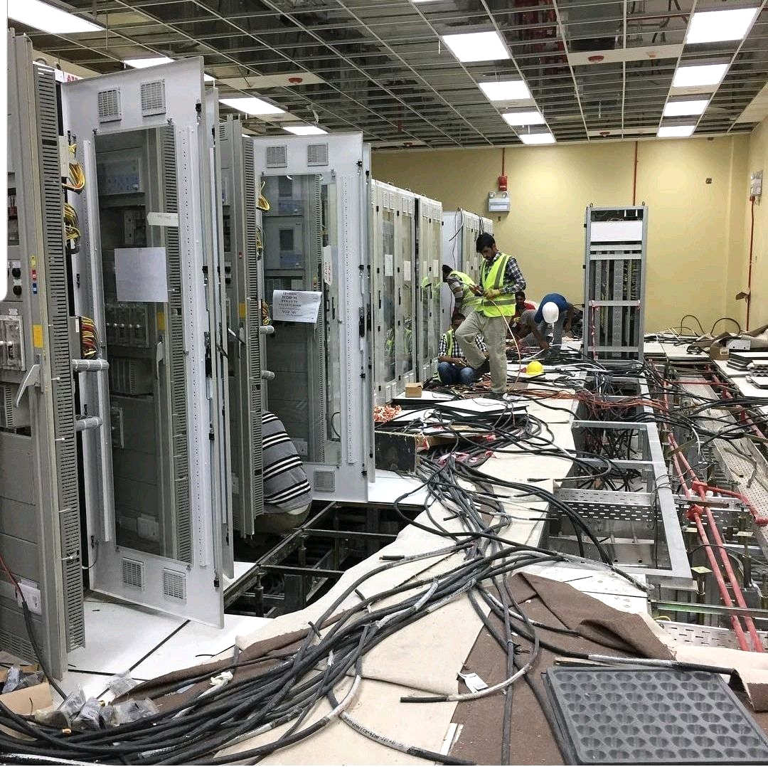

Figure 2 – Installation of digital relay protection and control panels

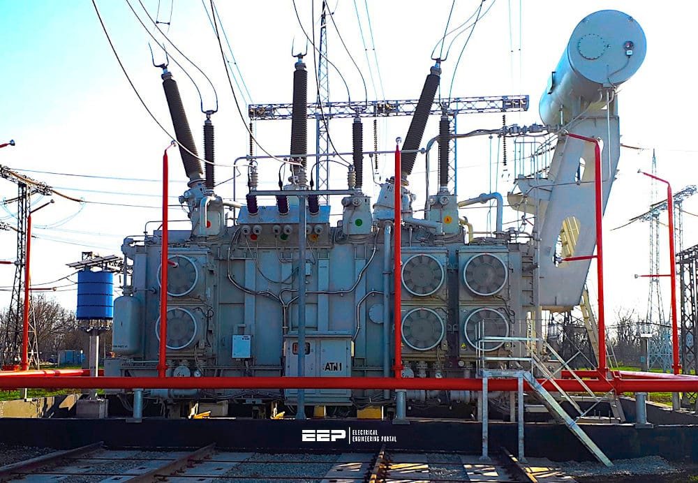

Figure 3 – Power transformer in a modern electrical substation
Practical Guide to Transformer Cooling Equipment
Figure 3 shows the massive physical Operational Technology (OT) infrastructure that outlasts the fragile IT components discussed in this section.
Conversely, the IEDs, Ethernet switches, Merging Units, and synchronization clocks that control these massive OT assets follow an IT lifecycle. After four to five years, this hardware begins to face severe operational realities:
