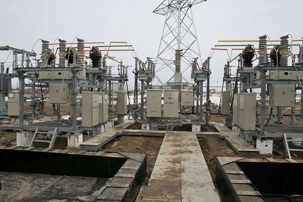

All actions involving substation construction require heavy planning. This is especially true of a program of substation uprating or expansion. The trend is toward the assessment of existing substations and individual equipment to develop a predictive maintenance and substation life extension program. There are many figures that need to be carefully planned.
Uprating and expanding existing power substations (good practice and recommendations)
This approach implements a planned program for evaluating substation components and making modifications or individual equipment replacements to improve reliability and extend the overall substation life. Such a program can be operated in conjunction with uprating or expansion planning to optimize the replacement and maintenance of substation equipment.
For instance, major substation uprating or expansion planning might include the replacement of existing outdated protection relays with modern microprocessor relays for improved substation protection and monitoring.

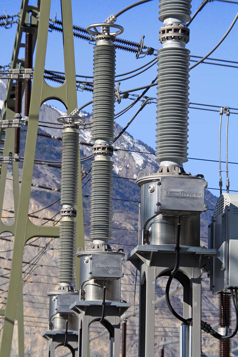

1.1.2 Oil Circuit Breaker
Increasing the MVA capacity of a substation may necessitate increased circuit breaker ratings. Breakers may be inadequately rated for increased continuous and momentary currents and interrupting duty. Consequently, determine the fault and continuous current requirements of all associated breakers.
The existing oil circuit breakers may be adequate for the increased full load current but inadequate for the interrupting duty to be imposed. Give the manufacturer of the breakers complete nameplate and purchase data together with the ultimate full load current and asymmetrical fault current expected from the uprating program. From this data, the feasibility of the program can be determined as far as the breakers are concerned.
New contacts and bushings may possibly overcome any full load current deficiency. Replacement of interrupter units could safely handle the increased interrupting duty.
The application of capacitors on a substation bus causes severe capacitive current switching duty. Compare rated capacitive switching current for the existing breakers with the anticipated duty to determine the need for breaker mechanism modifications. Consult the breaker manufacturer to determine the need for such modifications.
