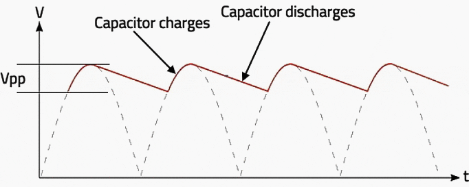

As you can see the output current looks like a rough DC or just a current wave that doesn’t include the negative side of the current. Therefore, this current needs to be converted into a healthy DC and the best way to achieve that is by connecting a capacitor that will smooth the output current.
This capacitor is the VFD’s second stage, called the DC filter. Because of the charging and discharging effect of the capacitor, the current passing through the DC filter will have a wave, as shown in Figure 4.
After the DC is considered smooth, it is ready to pass through the third stage of the VFD – the IGBTs inverter to convert it into AC again. When the current reaches this stage, the converted AC’s frequency could be varied accordingly. The connected number of IGBTs here will be turned on and off very fast to produce an AC-like waveform that will run the connected motor as if it was connected directly to an AC supply.
The IGBTs here act like switches that when rapidly switched on and off, create the Pulse-Width Modulation (PWM) that is a key to allowing a VFD to control the speed of the motor.
Figure 4 – Effect of a Capacitor on a Rectified Signal
