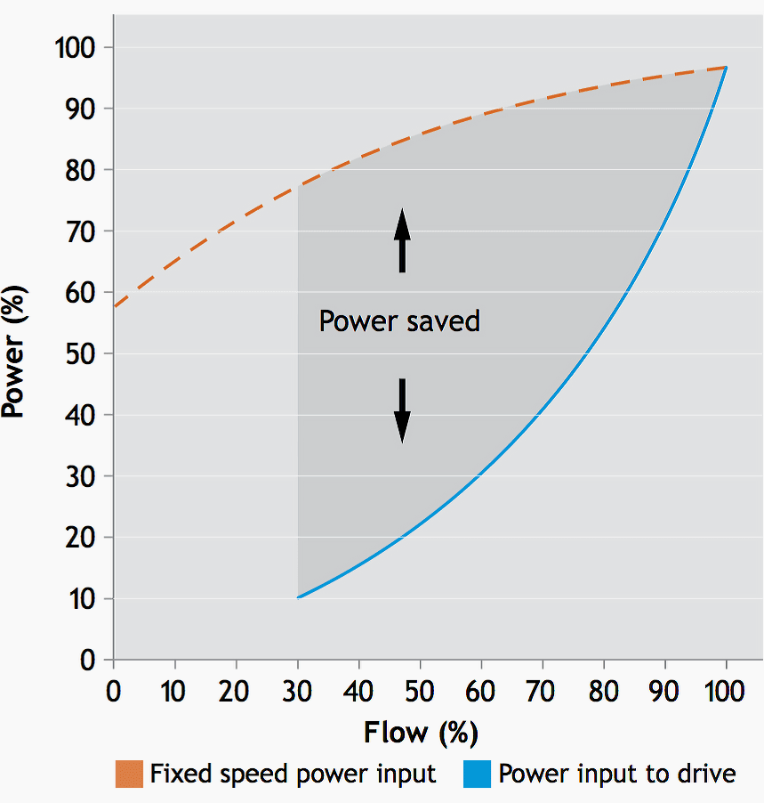

In a similar way to using damper control in fan applications, using throttle control for pumping applications results in a poor efficiency as the pump is not being run at its design point. This is particularly true for applications with a steep flow/head characteristic, where there is a high static head such as in underfloor heating circuits, geothermal pumps and for small pumps.
Further details on this will be available from equipment suppliers.
Using a variable speed drive to control the pump rather than using simple throttle control can result in significant power – and therefore cost – savings!!
This is illustrated in the graph, right, where the broken line indicates the power input to a fixed speed device and the solid line indicates the power input to a VSD. The shaded area represents the power saved by using a VSD for a given flow.
Power saved using a VSD in a pump
Figure 4 – Power saved using a VSD in a pump
Note: To be strictly accurate, there is a crossover point where a VSD can use more energy than a fixed speed power input. This is because of the losses inherent in VSDs which are not balanced by savings when incorrectly used.
It is important to note that on systems with a high static head (for example, boiler feedwater pumps), where the pump must overcome the inherent resistance of the system before any flow starts, the benefits of using VSDs will be slightly reduced.
This is because the additional resistance affects the relationship between the speed of the pump and the flow. Factor this into any calculations and consult an equipment supplier for further information if needed. Typical examples of pump applications for VSDs include moving hot water in HVAC systems, boiler feedwater pumps and product flow pumps, such as chemicals or inks.
