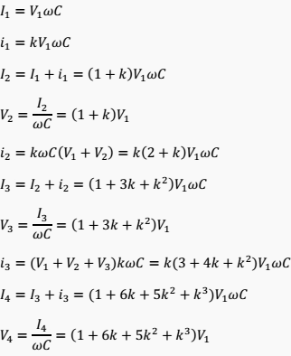

So let us consider a strain of four suspension insulators, as shown in the figure below, and let C be the same capacitance for each unit and kC the capacitance of each metal connector with earth.
Four insulators strain
Then, if V1 is the potential difference between the two metal connectors (clips) of the first insulator, we have:
If V1 is the potential difference between the two metal connectors
Even V1 + V2 + V3 + V4 = E (phase voltage of the line) → E = V1 (4 + 10k + 6k2 + k3)
So, if k = 0,1, we have:
Phase voltage of the line
From the results it appears that the first insulator has only one fifth of the total voltage, while the latter has almost one third.

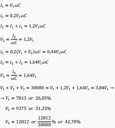

Case 1
Determine the potential distribution in a strain of three insulators, if the capacitances of the links to earth and to the line are respectively 20% and 10% of the capacitance of the insulators. Also, determine the performance of the strain.
Three insulators strain with capacitances to earth and to the line
Three insulators strain formulae
Performance of the insulators strain formulae

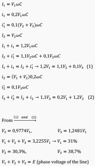

Case 2
An overhead 3-phase transmission line, which has phase voltage 30 kV, is hanging from a three insulators suspension strain. The capacitance between the links and the earth is 0,2 C, where C is the capacitance of an insulator.
  1. Determine the potential distribution along the insulators strain.
  2. If a protective (corona) ring inserts capacitances from the line, with the link of the middle and the lower insulator set at 0,4 C and the link of the medium and the higher insulator set at 0,1 C, find the new distribution.

2.2 Protective (corona) ring inserts capacitances from the line
Insulators strain with Corona ring

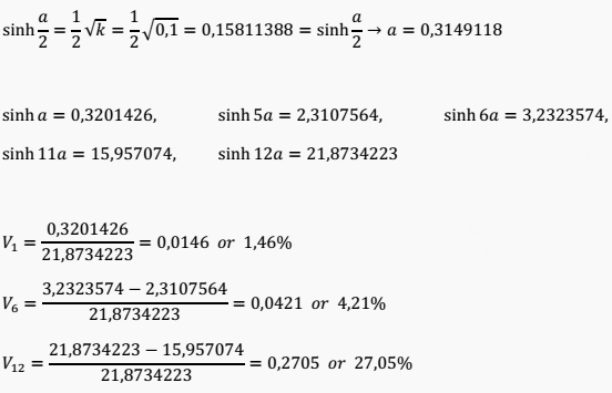

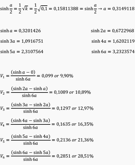

4.1 Determine the voltage distribution in a six insulators strain (z=6) with k=0,1
Voltage distribution in a six insulators strain
4.2 Determine the voltage distribution of the first, the sixth and the twelfth insulator with z = 12 (12 – insulators strain) and k = 0,1
We have:
