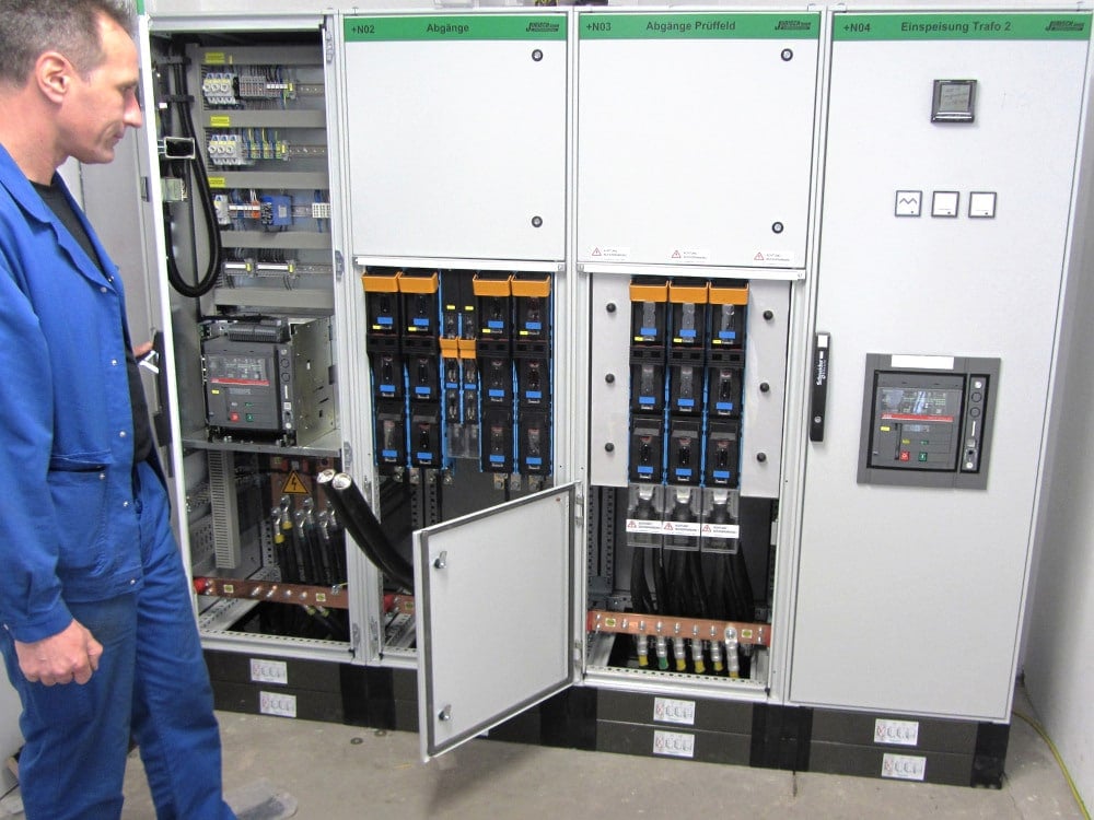

Figure 1 – A standard indoor installation of low-voltage switchgear. Even in climate-controlled rooms, internal heat generation must be strictly managed.

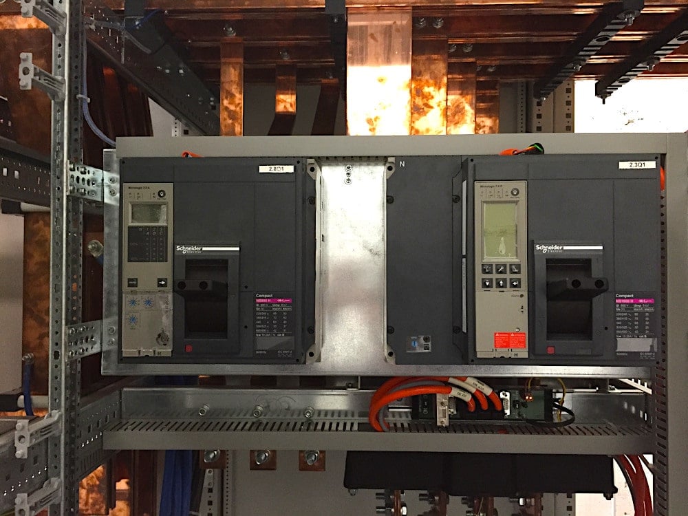

A LV switchgear accommodates a number of devices in a configuration that relates to the scheme requirements. The enclosure and compartments within it provide the operating environment for each device. Most devices e.g. circuit breakers, fuse switches, contactors etc. have been Type Tested in free air or “other enclosures”.
When enclosed within an LV switchgear compartment the heat liberated may adequately dissipate by convection and radiation from the “walls” of the enclosure and by heat sink via the conductors. It may however be necessary to assist the liberation to atmosphere by forced ventilation.
Figure 2 – LV switchgear compartments
LV switchgear compartments (photo credit: Eaton)

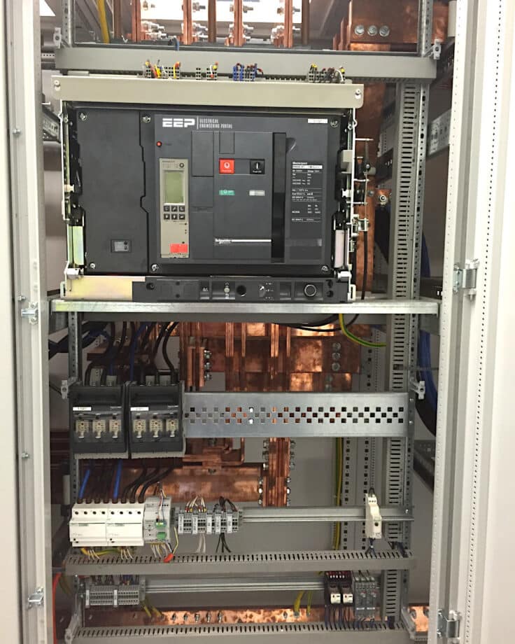

Figure 4 – The complex arrangement of busbars heavily influences both heat generation (via resistance) and heat dissipation (via surface area)
2.2 Contact Resistance and Joint Integrity
A solid busbar rarely fails from heat unless grossly overloaded. The weak links in any switchgear are the joints. Whenever two pieces of metal are bolted together, whether it is a cable lug to a breaker terminal or two busbars spliced together, there is a transition of electrons.
If a joint is improperly torqued, mechanically stressed, or oxidized, its micro-resistance increases. An increase in resistance of just a few micro-ohms across a joint carrying 2,000 amps will generate hundreds of watts of localized heat, creating a dangerous “hot spot“.
