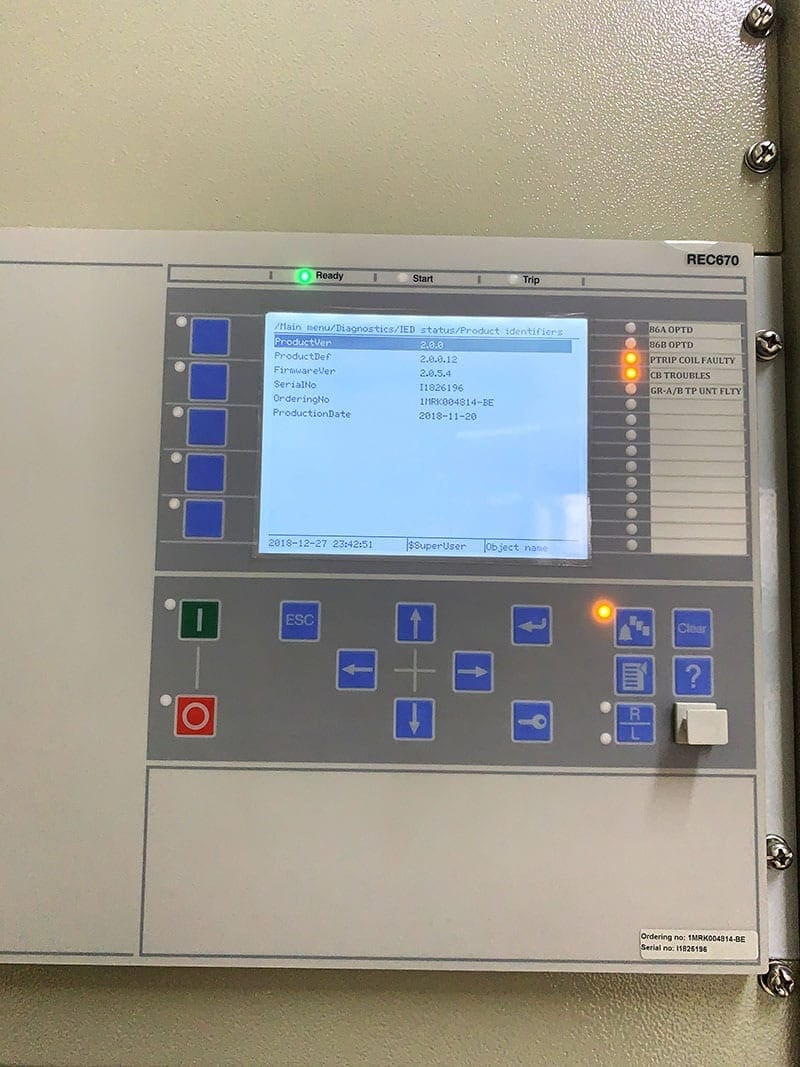

The foundation of substation automation systems, also known as SASs, is a large amount of specialized software that is kept in hardware components that are part of a set of substation secondary components.
Figure 1 – Advanced relay control and protection panel used in SASs
How backup protection is used to improve fault-clearing system in EHV networks
Figure 1 – Advanced relay control and protection panel used in SASs (photo credit: Kamran Ansari via Linkedin)

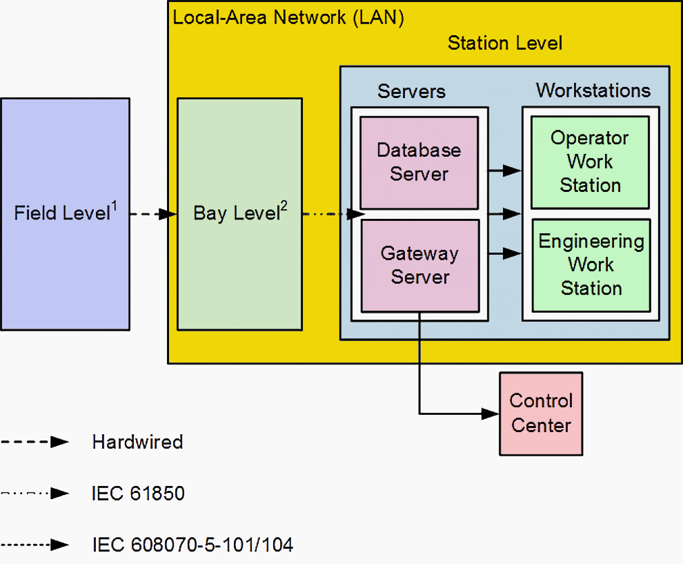

SASs can be built utilizing a straightforward method that makes use of more contemporary technology by integrating three distinct sets of devices together with two local area networks.
The process devices group is comprised of analog-to-digital converters as well as actuator devices, and its primary function is to facilitate the transition between SAS and high voltage equipment. The term “inteface devices” refers to a collection of “Intelligent Electronic Devices“, or “IEDs,” which are able to receive and process signals that are transmitted from high voltage apparatus.
The application devices group is comprised of all of the computers and other components that are necessary to successfully operate control features and interface with both internal and external subsystems.
Figure 2 – Simplified model of a substation automation system (SAS)
*** NCC stands for Network Control Center

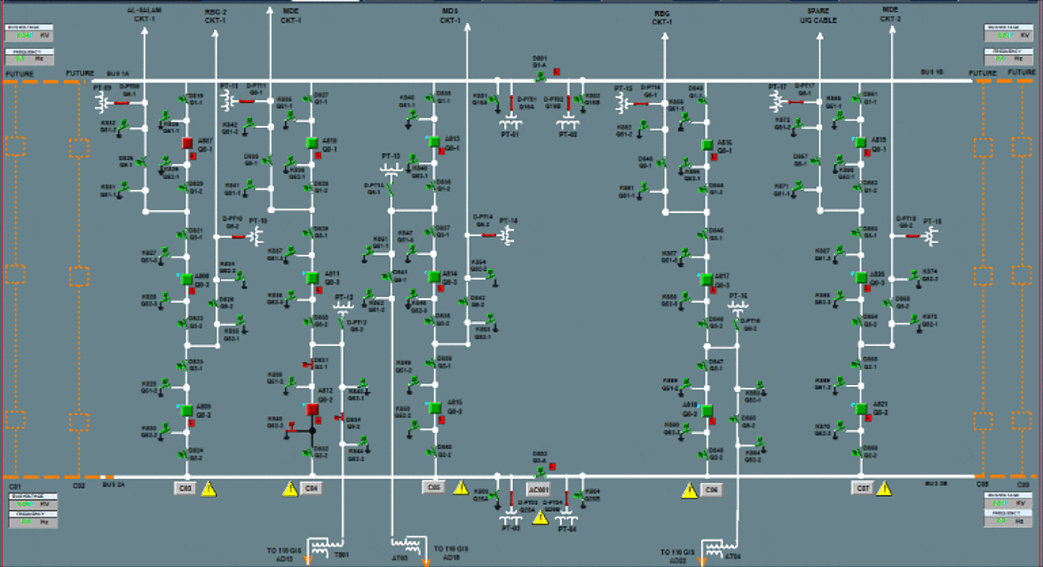

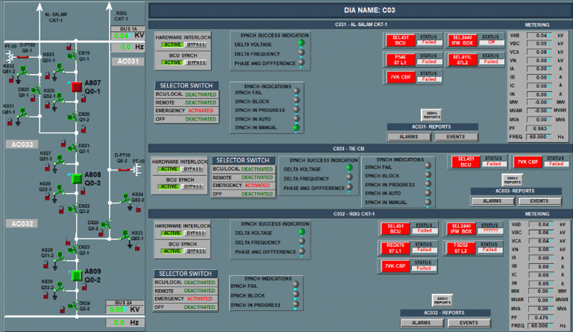

In a nutshell, SASs are responsible for handling the data acquisition process, as well as the control, monitoring, and alarming functions associated with high voltage equipment that is primary equipment. In addition, SASs are also responsible for handling the similar functions that are associated with secondary substation systems.
The operator is presented with control and monitoring information via a graphical interface that displays overview diagrams, control means, alerts, measurement, trends, and event sequences on user-friendly screens.
