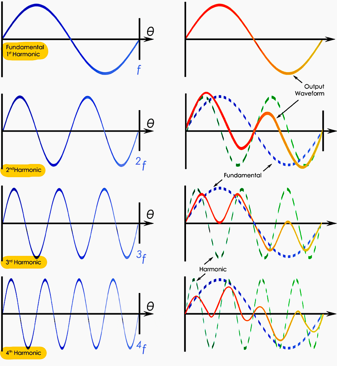

Figure 1 – Harmonics example
Harmonics example

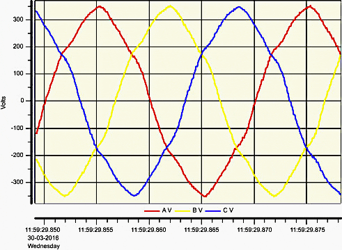

Figure 2 – Voltage Harmonics
Voltage Harmonics

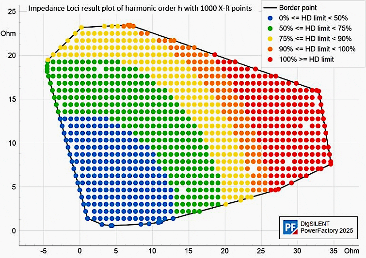

5.2 Harmonic Impedance Loci
The harmonic impedance loci describe how the network’s impedance varies at each harmonic order under:
  1. Different loading conditions
  2. Switching states
  3. Seasonal variations
  4. Contingencies (N-1 conditions)
These impedance characteristics determine how harmonic currents convert into harmonic voltages.
There are two primary formats:
Grouped Envelopes: Several harmonic orders are grouped into a single impedance envelope. These are conservative but less accurate.
Ungrouped Envelopes: Each harmonic order has its own impedance envelope. This is the preferred approach for detailed and accurate harmonic analysis because it:
  1. Identifies resonance risks more reliably
  2. Produces realistic incremental voltage estimates
  3. Supports advanced modelling (Stage 3 studies)
The impedance loci are fundamental for understanding whether the plant will interact negatively with network resonances or amplify harmonic distortion.
Figure 4 – Harmonics Impedance Loci

9.4 Request Ungrouped Impedance Loci from the DNO/ESO
Impacted harmonic orders may appear non-compliant due to grouped impedance envelopes, which are conservative. By requesting ungrouped (order-by-order) loci, developers can:
  1. Identify precisely which harmonic orders are problematic
  2. Reduce false positives caused by conservative grouping
  3. Target only the affected orders for mitigation
  4. Avoid expensive filtering across the full spectrum
This often reveals that harmonic exceedances occur under very narrow scenarios rather than across the entire harmonic range.

Harmonic measurement is commonly performed using point-on-wave data, FFT-based analysis, and sliding-window measurement techniques, all governed by the international standards IEC 61000-4-7 and IEC 61000-4-30.
10.1 Point-on-Wave (PoW) Data
Point-on-wave data consists of high-resolution, time-domain recordings of voltage and current waveforms at the PCC or other monitoring locations.
This is the most detailed form of measurement and captures:
  1. Fundamental frequency waveform
  2. Harmonic components
  3. Inter harmonics
  4. Flicker-causing variations
  5. Transients (switching events, inrush, faults)
  6. Sub-cycle distortions
