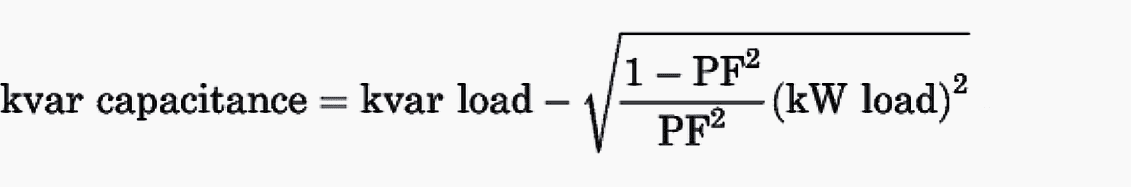

The capacitive kilovars required to raise the system to the desired power factor can be calculated as follows:
capacitive kilovars
where PF is the desired power factor.

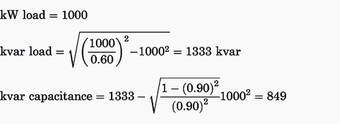

Let’s take an example…
For example, consider a 1000-kW load with a 60% power factor, which one wishes to correct to 90%:

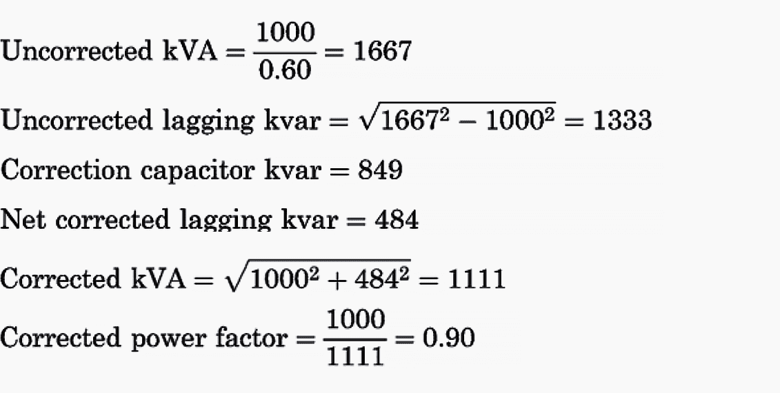

From Table 1, for the existing power factor (60%) and the corrected power factor (90%), the power factor correction factor is 0.849. Thus, the number of kilovars of capacitance required is 1000 × 0.849 = 849 kvar.
Let us verify this calculation:

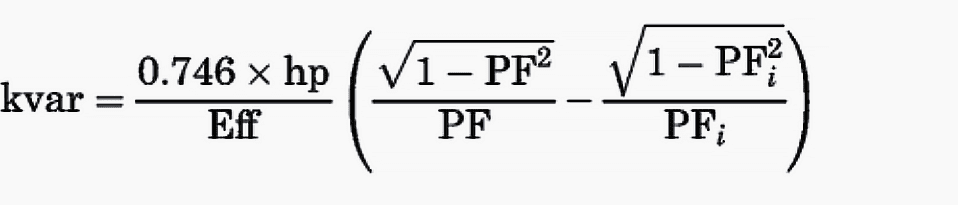

For safety reasons, it is generally better to improve the power factor for multiple loads as a part of the plant distribution system.
In those cases in which local codes or other circumstances require improving the power factor of an individual motor, the kilovar rating of the improvement capacitor can be calculated as follows:
kvar formulae
where

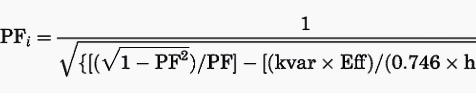

In some cases, it may be desirable to determine the resultant power factor PFi, where the power factor improvement capacitor selected within the maximum safe value specified by the motor manufacturer is known.
The resultant full-load power factor PFi can be calculated from the following:
PFi formulae
