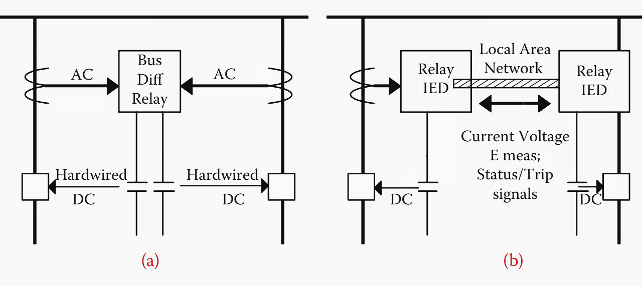

In the traditional approach, the relays had hardwired inputs from the instrument transformers, and from the relays, hardwires carried the trip signals to the circuit breakers, as shown in Figure 1.
Protection via hard wiring and (b) protection via LAN
Figure 1 – Protection via hard wiring and (b) protection via LAN
In the IED-based modern approach, the information from instrument transformers will reach the relay IEDs via LAN, the relays exchange information via LAN, and with the process bus becoming a reality, the circuit breakers will receive a trip signals via a generic object-oriented substation event (GOOSE) message traveling in the process bus, as illustrated in Figure 1b.

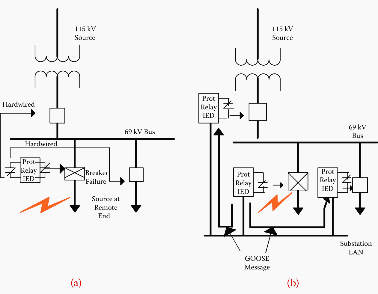

In case of a breaker failure, in the traditional protection wiring scheme, the hardwiring will carry the trip signal to the backup protection scheme, as shown in Figure 2a.
On the other hand, in a modern protection scheme, the backup protection is initiated via LAN as given in Figure 2b, which reduces the wiring tremendously and also will utilize alternate pathways.
(a) Protection via hard wiring and (b) protection via GOOSE messaging using LANs.
Figure 2 – (a) Protection via hard wiring and (b) protection via GOOSE messaging using LANs.
Protection functions like automatic reclosing and bus differential schemes can be implemented, and breaker failure can be dealt with effectively.

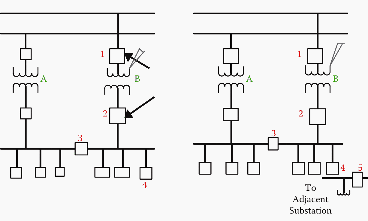

This scheme is generally used in a distribution substation where there are two transformers and a normally open bus tie breaker.
When a transformer in a substation fails, the simple bus failover scheme transfers the load to the healthy transformer in the substation, which may overload the healthy transformer and lead to another failure.
Hence, the bus failover schemes have been disabled in some cases.
The substation firm capacity is limited by the load (overload) that can be carried by the healthy transformer. However, in an intelligent bus failover scheme, the substation automation system will ensure that the healthy transformer is not overloaded.
This can be done by load shedding one or a few of the outgoing feeders temporarily. These feeders can be supplied from an adjacent substation by closing a tie switch, and the disruption in load can be minimized.
The beneft of this scheme is primarily improvement in reliability as the transfer of load is done as quickly as possible. Outage duration can be reduced from 30 min to 1 min. The scheme also allows better equipment utilization.
“Intelligent” load transfer will allow higher loading under normal conditions, as the substation firm capacity is limited to the amount of load that can be carried following a single contingency, like a transformer failure.
Intelligent bus failover demonstration
Figure 3 – Intelligent bus failover demonstration
Figure 3 shows the fault on transformer B. Circuit breakers 1 and 2 will trip and isolate transformer B, and circuit breaker 3 will be closed to transfer the load on to transformer A, which will get overloaded and may have to shed load by opening circuit breaker 4.
However, the load can be transferred subsequently by connecting the line to the adjacent substation automatically by closing breaker 5.

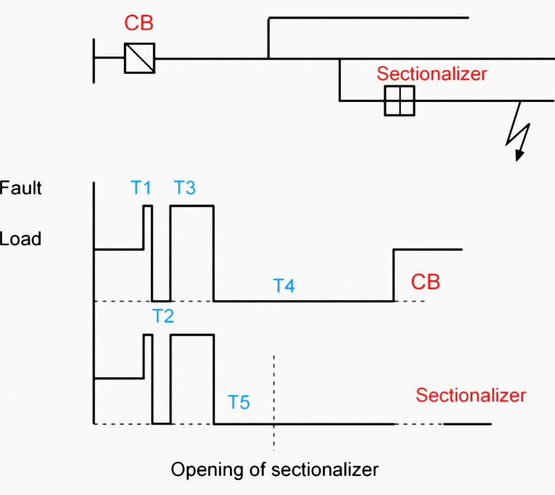

When the sectionalizer is equipped with a motor-operating mechanism, measuring transformers (or sensors) and local control and supervising features, the sectionalizer becomes a so called automated sectionalizer. With an automated sectionalizer, it is possible to build discriminative fault isolation schemes. The automated sectionalizer works in coordination with up-stream switching devices, utilizing the de-energized periods during the autoreclosing scheme to operate and isolate faulty sections.
The automated sectionalizer counts the reclosing attempts made by the upstream device, like reclosing breaker at the upstream substation, and after a pre-selected number of attempts, it automatically opens during the de-energized period of the autoreclosing sequence.
Following diagram shows a simple radial feeder case of utilizing the functionality of an automated sectionalizer together with the circuit breaker’s autoreclosing scheme for discriminative fault isolation.
An example of utilizing sectionalizers for discriminative fault isolation in radial feeder application
Figure 4 – An example of utilizing sectionalizers for discriminative fault isolation in radial feeder application
When the fault appears on the overhead line section beyond the sectionalizer, the protective relaying at the supplying substation and at the sectionalizer recognizes the case.
The protective relaying at the substation starts the autoreclosing sequence by tripping the circuit breaker in time of T1. The sectionalizer acknowledges this action. After a preset time delay (T2), the circuit breaker recloses. Since the fault has not been cleared, the circuit breaker trips again after a preset time delay of T3. The sectionalizer commences its opening cycle during the feeder’s de-energized period of T4.
The actual sectionalizer opening command is issued after a preset time delay of T5.
After the time delay of T4 of the autoreclosing scheme has elapsed, the sectionalizer is fully open and the circuit breaker recloses, energizing the healthy sections of the feeder.

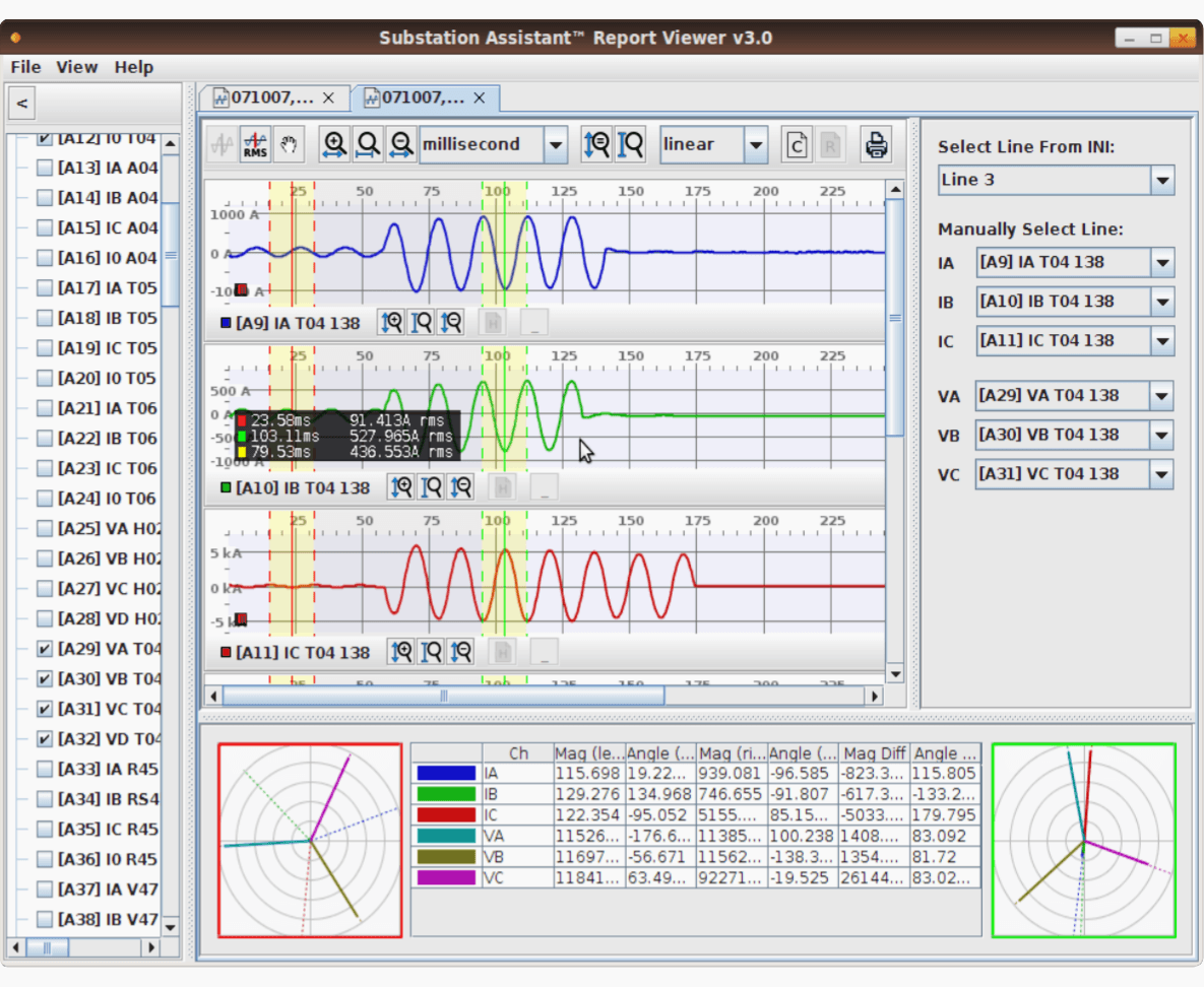

Disturbance analysis is an added advantage when IEDs are implemented, as they have inherent capabilities to record the fault waveform, and also the facility to time stamp the measured operational data.
These values can be used to recreate a disturbance sequence as the time stamping to the level of milliseconds or less will help the operator and other personnel in the utility to assess the situation and take corrective action for the next disturbance.
Substation disturbance analyser desktop-based user interface
Figure 6 – Substation disturbance analyser desktop-based user interface
For example, in case of an islanding of a section of the power system, the faults, line tripping, overloading and underloading, and tripping of generators may happen in quick succession. After the islanding the utility personnel must assess the situation and determine the correct sequence of events.
Time stamping of events, analog, or status changes immensely helps the utility to recreate an event and do a thorough analysis of the situations that led to the islanding. The waveforms captured can be used by the maintenance and protection departments to assess the severity of the damage and take corrective action.

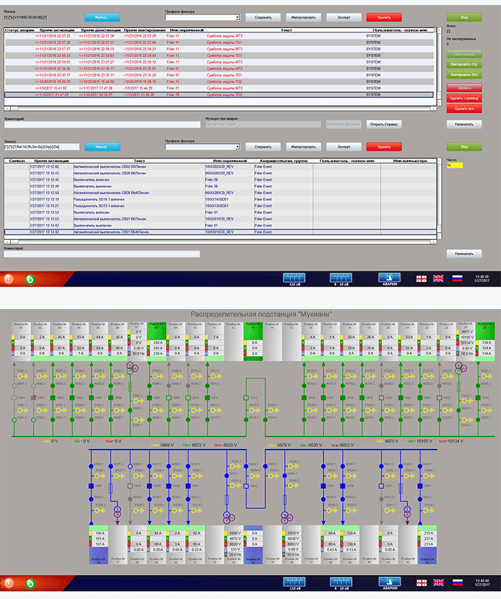

Intelligent alarm processing is of utmost importance in a control room to help the operator from getting confused by the battery of alarms triggered by an event.
The screen of substation SCADA showing alarms and events
Figure 5 – The screen of substation SCADA showing alarms and events (photo credit: GeniSYS LLC)
