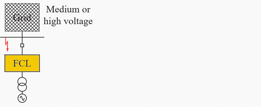

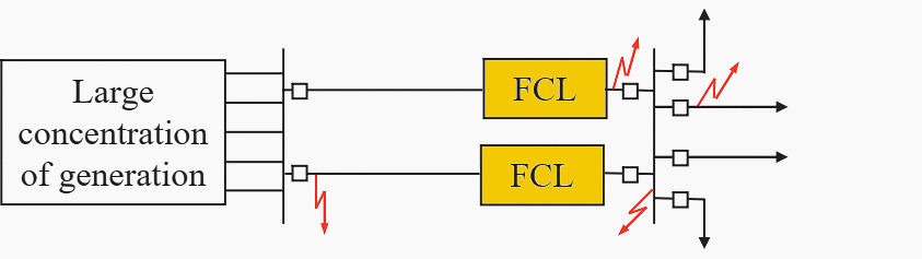

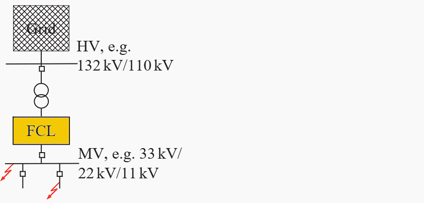

Besides their main benefits of avoiding the otherwise unnecessary replacement of switchgear, fault current limiters introduce additional benefits caused by the reduction of stresses on equipment during short-circuit faults. A number of concomitant economic benefits include increased power plant life by limiting let-through current, lower thermal, mechanical and electrodynamical stresses of equipment, improved network capacity by allowing several transformers to operate in parallel and possibly lower need for spares.

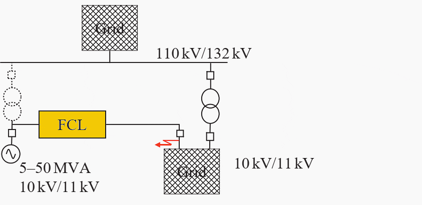

As energy demand rises and more distributed generation and clean energy sources, like wind and solar, are added to an already overburdened system, the need for fault current limiters (FCLs) is being pushed by rising system fault current levels.
Explosive fault-limiting fuses are currently used to reduce fault current, however they must be replaced after blowing and are only suitable for voltages below 35 kV. Series reactors are also employed, although they are bulky, have substantial reactive losses that are constant, and they lower grid voltage. These issues are resolved by fault current limiters (FCLs).
Additionally, when fault current levels rise, larger and frequently more expensive high impedance transformers are required. FCLs, in contrast to these transformers, operate normally with little to no impedance, resulting in a more stable system.
In this technical article, we briefly describe established and emerging fault current limiter technologies as well as their examples.

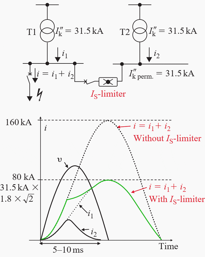

2. Pyrotechnic-based fault current limiters
These fault current limiters, also known as ‘IS-limiter’, are widely used in low and medium voltage systems and industrial power systems at nominal voltages up to 40.5 kV with interrupting currents up to 210 kA symmetrical rms.
The IS-limiter is a device that consists of two parallel conductors as shown in Figure 2. The first is the main conductor that carries the load current under normal unfaulted system operating conditions. The second is a parallel fuse with a high breaking capacity that limits the short-circuit current at the first current’s rise and interrupts it at the next current zero.
Figure 2 –  Insert and insert holder of the IS-limiter
Figure 3 shows the effect of IS-limiter operation where the two sources of fault currents are characterised by an rms current equal to 31.5 kA and a peak factor equal to 1.8 giving an initial peak asymmetric current of 80 kA.
The IS-limiter is activated by a small charge that opens the main conductor and diverts the short-circuit current to the fuse. The normal instantaneous current through the IS-limiter is monitored by an electronic measuring and tripping circuit. Both the current and its rate of rise are continuously evaluated and compared to selected set points.
If both set points are simultaneously reached, the IS-limiter trips and the total operating time to current interruption is 5–10 ms. After an operation, the IS-limiter insert (one unit per phase), i.e. the main conductor, the parallel fuse and the charge need to be replaced.
These limiters can be used in a variety of applications such as to couple substation busbars, connection of two separate subsystems, connection in series with generator feeders or in parallel with a current limiting reactor, etc.
Since the current is generally limited and interrupted before the half cycle asymmetric peak is reached, as illustrated in Figure 3, the IS-limiter current will not contribute to this initial half cycle peak current.
Figure 3 – Performance of the IS-limiter

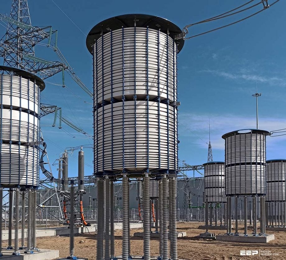

3. Permanently inserted current limiting series reactor
Short-circuit current limiting series reactors have been used in power systems at almost all voltage levels for decades. They introduce a leakage impedance into the current path which limits the fault current.
Because they are permanently inserted in the system, i.e. under normal unfaulted system conditions, they have several disadvantages. These include:
  • they introduce a voltage drop,
  • have active and reactive power losses,
  • may adversely affect the optimum distribution of power flow in interconnected networks,
  • may also adversely affect the transient and dynamic stability performance of power systems.

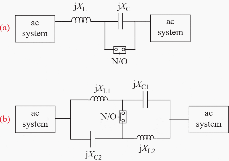

4. Series resonant current limiters using a bypass switch
To eliminate the active and reactive power losses in bus tie applications using single reactor component, an alternative is to use a power frequency tuned resonant series inductor and capacitor combination. The combination has a zero impedance under normal operating conditions.
To limit the fault current, the capacitor element is shorted out using a fast closing bypass switch. A variant of this approach is to use a series/parallel arrangement of tuned inductors and capacitors in order to create two parallel tuned elements in series by the operation of a single bridging switch at the circuit mid-point.
Both circuits are shown in Figure 4.
Some of the disadvantages of these circuits are that a number of large components are mounted at line potential and there may be a risk of sub-synchronous resonance which may damage turbo-generator shafts. In the second circuit, if all the inductive and capacitive reactances are chosen to be equal, the impedance switches from zero to almost an infinite value, and while this is very attractive, may be impractical because of its significant adverse effect on downstream protection.
Also, the shorting switch may have to close near zero voltage across the capacitor to avoid a very large transient current duty.
Figure 4 – Series resonant fault current limiters using a bypass switch in two designs
Figure 4 – Series resonant fault current limiters using a bypass switch in two designs (a,b)

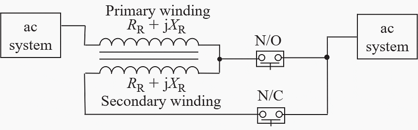

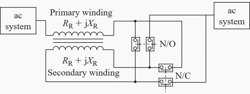

5.1 Flux cancelling limiter with reverse parallel to series reconnection
This is shown in Figure 6. When an external short-circuit fault occurs, the direction of the secondary winding is reversed so that the induced voltage adds to the voltage across the self-inductance of each winding, instead of subtracting, and hence doubles the effective impedance in series with the network.
The normally open switches carry the limited short-circuit current whereas the normally closed switches carry the load current.
Figure 6 – Fault current limiters using magnetically coupled circuits: flux cancelling limiter with secondary winding polarity changeover

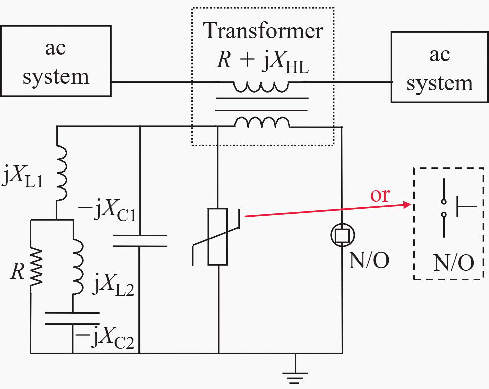

7. Passive damped resonant limiter
Figure 8 illustrates one phase of a three-phase damped resonant limiter circuit using only passive components. The limiter consists of an isolation transformer whose primary winding is connected in series with the system and a capacitor is connected across its secondary winding. A non-linear resistor, e.g. a varistor, or a fast closing triggered switch, is connected in parallel with the capacitor and a damped tuned filter is connected in parallel with the varistor.
Under normal unfaulted system condition, the secondary circuit appears as a capacitor at 50 Hz that when transferred to the primary of the transformer, is equal to and hence cancels out the transformer’s leakage reactance. Therefore, at 50 Hz, the limiter appears as a short circuit except for the resistance of the transformer.
When a short circuit fault occurs in the power system, the increase in current flowing in the transformer’s primary winding causes a corresponding increase in the secondary winding’s current. The rise in voltage across the secondary winding impedance would cause the varistor or switch to conduct and short circuit the capacitor.
Thus, the effective impedance that remains in the primary circuit is the transformer’s leakage impedance and this acts to limit the fault current to the desired value. A circuit-breaker in parallel with the varistor or switch may be used to short circuit the secondary and reduce the energy absorption duty on the varistor. The fault current limiting described can be obtained without the circuitry involving XL1, R, XL2 and XC2.
However, with series capacitors in transmission systems, sub-synchronous resonance phenomenon has occurred and caused damage to turbo-generator shafts.
Figure 8 – Passive damped resonant fault current limiter
Thus, the purpose of this circuitry is to provide damping at sub-synchronous frequencies. The circuit consists of a reactance XL1, and a ‘C’ filter whose XL2 and XC2 are tuned at power frequency (50 or 60 Hz), so that the damping resistor R is short-circuited at this frequency.
XL1, is used because the filter can not be connected across the main capacitor XC1 to avoid short-circuiting this capacitor. The value of XL1 is chosen so that at power frequency, the parallel combination of XL1 and XC1 appears as a capacitive reactance whose value is equal to the leakage reactance of the series transformer.
In summary, the limiter has a negligible impedance under normal unfaulted system operation and a fault limiting reactance equal to the transformer’s leakage reactance under short-circuit conditions. A damping circuit is included to reduce the risk of sub-synchronous resonance. The modelling of this limiter as a leakage impedance in short-circuit studies is straightforward.

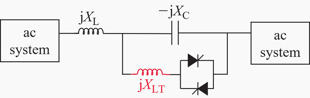

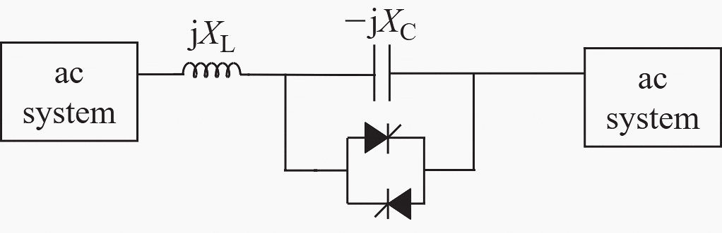

8.1 Series resonant limiter using thyristor protected series capacitor
Figure 9 illustrates this type of limiter which is based on a flexible AC transmission system series compensation device called the thyristor protected series capacitor. In parallel with the capacitor is a power electronic switch that consists of anti-parallel thyristors. Under normal unfaulted system operation, the thyristor switches are not conducting current, and the series inductance and capacitance are tuned at power frequency.
Therefore, only the inductor’s resistance remains in the circuit and this incurs active power losses. Under system fault conditions, the thyristor switches are made to conduct the fault current and bypass the capacitor thus inserting the reactor impedance into the fault path within a few milliseconds.
The reactor acts to limit the fault current.
Figure 9 – Fault current limiters using thyristor protected series capacitor

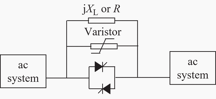

8.3 Solid state limiter using normally conducting power electronics switches
This type of fault limiter is illustrated in Figure 11. It consists of a power electronics switch that is connected in series in the AC system. A fault limiting resistor or reactor is connected in parallel with the switch.
Under normal unfaulted system operation, the switch conducts and carries the normal load current and the fault limiting resistor/reactor is short-circuited. When a system short-circuit fault occurs, the rising fault current is detected and the switch is turned off thus diverting the fault current to the parallel resistor/reactor which acts to limit the fault current.
The fault current limiting is accomplished within a few milliseconds. The use of a current limiting resistor brings the useful benefit of reducing the phase angle difference between the voltage and current and quickly removing the dc fault current component.
A varistor may be connected in parallel with the switch to limit the transient voltage that appears across it. The switches may accomplish the current switch off using gate turn off thyristors or modern alternatives. Because they are normally conducting, the switches incur on-state active power losses and these are typically 0.1–0.2% of the throughput power.
Figure 11 – Solid state fault current limiter using normally conducting power electronics switches

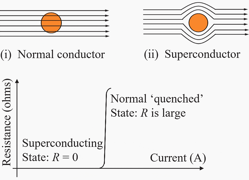

A superconductor is a wire or a coil such as Bismuth-2233 or YBa2Cu3O7 that, when cooled, acts as a perfect conductor that has a zero resistance. Beyond a certain critical limit of a particular property, the conductor loses its superconductivity state and transition to a normal high resistive state. The property referred to is the conductor critical temperature, critical current or current density, or magnetic field.
Figure 12 illustrates the magnetic field and resistance/current, properties of a superconductor.
Cryogenic cooling equipment is used to cool the superconductor using liquid nitrogen and for high temperature superconductors, the cooling temperature is less than −100°C. The ‘high temperature’ term refers to material that becomes superconductors at temperatures that are typically above 30°K.
The transition from the superconducting to the normal resistive state occurs automatically within a few milliseconds. No special devices or circuitry is needed to detect and trigger the fault limiting action since the transition in the state material is only dependent on the magnitude of the current flowing through it.
Figure 12 – Basic electrical property of a superconductor: magnetic flux lines and resistance/current characteristics of a high temperature superconductor
Basic electrical property of a superconductor: (a) magnetic flux lines and (b) resistance/current characteristics of a high temperature superconductor
Figure 12 – Basic electrical property of a superconductor: (a) magnetic flux lines and (b) resistance/current characteristics of a high temperature superconductor
In practical installations, recovery of the superconducting property should occur quickly in order to limit and withstand subsequent faults in the power system within a short period of time.

Figure 16 illustrates a fault current limiter application in series with a transformer in a high-to-medium voltage substation. The limiter acts to limit transfomer fed short-circuit currents for faults on the medium voltage substation.
Figure 16 – Fault current limiter in high-to-medium voltage transformer circuit
Figure 17 illustrates a fault current limiter application in series with a generator–transformer circuit. The limiter acts to limit the short-circuit current infeed from the generator for faults on the high voltage substation and the generator terminals.
Figure 17 – Fault current limiter in series with a generator–transformer circuit

Figure 19 illustrates a fault current limiter application in series with circuit feeders that export power from a large concentration of generation plant located at one or several locations.
Figure 19 – Fault current limiter in series with exporting circuits connecting large concentration of generation
Figure 20 illustrates the connection of a generator through a fault current limiter to a medium voltage grid to limit the generator’s short-circuit contribution to faults within this grid.
In this example, the limiter serves as an alternative to a transformer (and switchgear) connection to the high voltage grid.
Figure 20 – Fault current limiter facilitating the connection of a generator to a local grid
