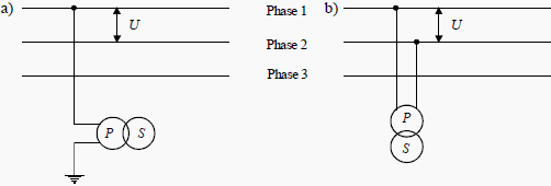

Rated primary voltage (Up): Depending on their design, voltage transformers will be connected either:
  1. Between phase and earth (see Figure 1a); or
  2. Between phases (see Figure 1b).
Rated primary voltage formulae
Voltage transformer connections
Figure 1 – Voltage transformer connections
