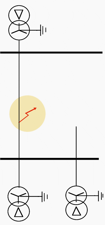

1. Fault Resistance and Fault Current Levels
In order to calculate fault currents in an effectively earthed system we must use the representation with symmetrical components. The symmetrical component scheme for a 132 kV system with a fault according to Figure 1 is shown in Figure 2.
An earth fault in a direct, effectively earthed system
Figure 1 – An earth fault in a direct, effectively earthed system
The distribution of fault currents, from the different system earthing points, can be derived from the distribution in the zero sequence network (see Figure 2 below). By inserting varying fault resistances one can get the fault current level.
The fault resistance Rf, consists of the arc resistance and the tower foot resistance. The arc resistance is calculated by the formula:
Rarc = 28700×a / If1.4 (according to Warrington)
where a, is the arc length in meter, normally the insulator length, and If is the fault current in A.
A calculation will show that values will differs from below 1 Ω for heavy faults, up to 50-400 Ω for high resistive earth faults. The tower foot resistance depends on the earthing effectiveness of the towers, whether top lines are used etc.
For the tower foot resistance values from below 10 Ω up to 50 Ω have been documented.

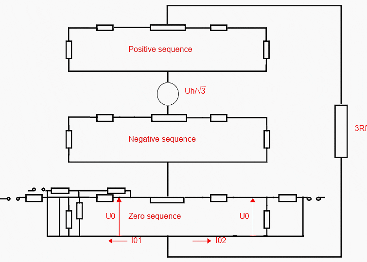

The symmetrical components are used to calculate the 'I0' current for the fault in figure 1, '3I0' is the total fault current
Figure 2 – The symmetrical components are used to calculate the ‘I0’ current for the fault in figure 1, ‘3I0’ is the total fault current

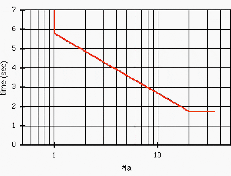

4. Logaritmic Inverse Relay
Detection of earth fault and back-up tripping with maintained selectivity in a solidly (effectively) earthed system is rather complicated due to the infeed of fault current from different direction concerning all faults.
A special inverse characteristic with a logaritmic curve has been developed to be suitable for these applications. The principle for earth fault relays in a effectively earthed system is shown in Figure 5 and the logaritmic inverse characteristic is shown in Figure 6.
The inverse characteristic is selected so that if the current of the largest infeed is less than 80% of the faulty objects current selectivity is achieved.
Earth fault protection in a solidly earthed system
Figure 5 – Earth fault protection in a solidly earthed system
To enable use together with distance protection giving single-phase tripping a definite minimum time is set (normally 0.3 sec.). This ensures that a single phase tripping for heavy single phase faults can be done by distance protection relay first.
The logaritmic inverse characteristic
Figure 6 – The logaritmic inverse characteristic. A fault current of the biggest infeed less than 0,8 times the current of the faulty object, gives a selective tripping.

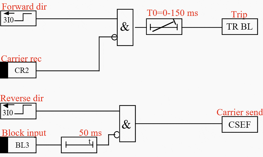

In a blocking scheme the directional earth fault relays are provided with a reverse locking element as a complement to the forward element. The reversed element is set to be more sensitive than the forward element and will, when a reverse fault is detected, send a carrier signal (CS), to the remote end.
At the remote end the forward element is provided with a short time delay T0 normally set to 50-150 ms, to check if a blocking signal is received. If not, the relay will trip. The same situation will for internal faults occur at both line ends. The principle of a blocking scheme is shown in Figure 8.
A blocking scheme with directional earth fault relays
Figure 8 – A blocking scheme with directional earth fault relays

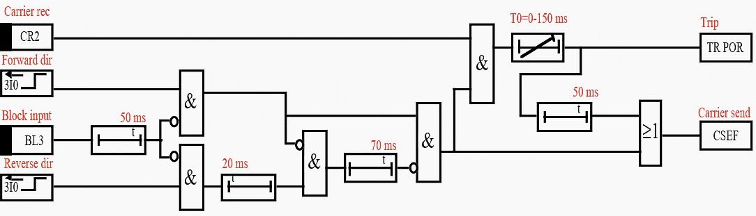

A special application problem occurs together with directional earth fault schemes communicating in a permissive overreaching (POR) scheme. The problem is fault current reversal which occurs when the CB at one end of the faulty line trips before the breaker at the other end.
The fault current changes direction in the parallel line and a timing problem to prevent maloperation at the end with a carrier signal (CS) receipt at the original fault occurring will occur (see Figure 9).
The current reversal problem at parallel lines
Figure 9 – The current reversal problem at parallel lines
A special logic according to Figure 10 is required to prevent a unneccesary function.
A logic in directional earth fault relays, to prevent unnecessary operation during current reversal
Figure 10 – A logic in directional earth fault relays, to prevent unnecessary operation during current reversal
