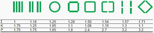

Another characteristic example is the tubular conductor whose optimized shape guarantees a coefficient K close to 1; however this tube has the smallest cooling surface (without any forced ventilation on the inside) and it can be seen in Figure 4 that it is far from having the profile which carries the highest current, for a heating and a cross-section the same as other configurations.
Figure 4 - comparison of profiles having equal total cross-section
