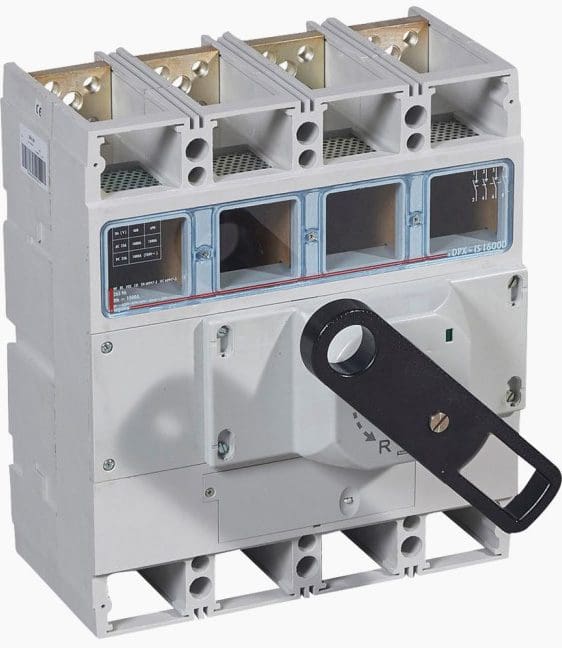

Figure 3 – Isolating switch 4P 1000 A with front handle (Legrand)

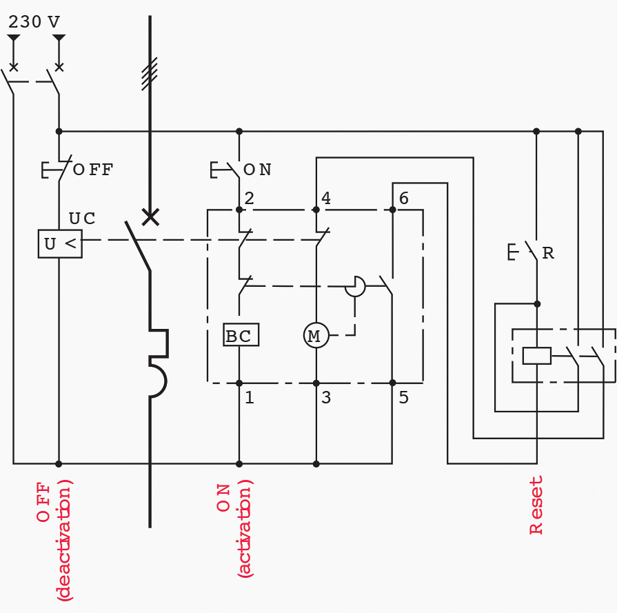

Figure 6 – Motor-driven control for a circuit breaker with reset by the external handle. Opening by undervoltage release.
Motor-driven control for dPX circuit breaker with reset by the external handle. Opening by undervoltage release.

Where:
  • AC – auxiliary contact
  • FS – fault signal contact
  • SC – shunt coil
  • UC – undervoltage coil
  • EB – emergency breaking
  • ON – On button
  • OFF – Off button
  • R – reset

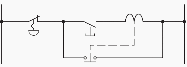

2. The emergency stop
When movements produced by electrical devices or machines can be the source of danger, these devices or machines must be equipped with emergency stop device(s) located as close as possible to the users. Emergency stops are required for example for escalators, lifts and elevators, cranes and transporters, electrically controlled doors, car washes, etc. and of course for machines: mechanical kneading machines, handling robots, and machine tools in the broadest sense.
Each machine must be fitted with one or more emergency stop devices, which are clearly identifiable, accessible, in sufficient numbers, avoiding dangerous situations arising or continuing.
The stop can be immediate, controlled or delayed, depending on the requirements of the machine, with the power supply only being cut off when the stop takes place. It’s important to note that the emergency stop is not required:
  1. If its presence does not reduce the risk
  2. If the stopping time is not shorter than the emergency break
  3. For portable machines and manually guided machines.
The emergency stop must be activated by as direct action as possible and with the notion of “positive safety”: direct action on the contacts opening the circuit or stop given priority in the event of a fault on the equipment or the power supply.

2.2 Examples of emergency stop schematics
Figure 9 – Conventional layout of supply to a relay with switch-off priority

3. Isolation
Isolation is used to separate an installation or part of an installation electrically. The purpose of isolation is to ensure the safety of people working on it. A breaking device providing the isolation function must be installed:
  1. at the origin of all installations
  2. at the origin of each circuit or group of circuits
The isolator must break all the live conductors (including the neutral). PE and PEN conductors must not be broken. Isolation does not have to be carried out in a single operation (commoning links, fuse carriers), although multi-pole devices are preferable. If there is a risk of back feed, isolation upstream and downstream of the installation may be necessary.
The devices which carry out isolation may be isolators, isolating switches, circuit breakers, power sockets, fuse carriers, isolating blades, disconnect terminals or any device which provides a minimum contact opening distance of:
  • 4 mm for 230/400 v voltage
  • 8 mm for 400/690 v voltage
  • 11 mm 1000 v voltage
For double break devices, the distances must be multiplied by 1.25.

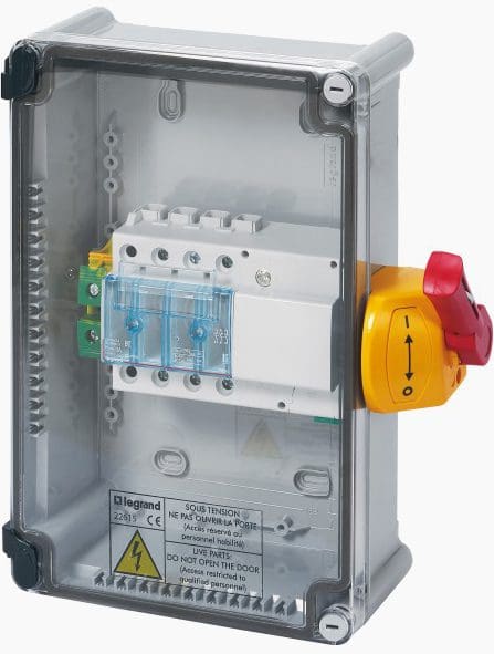

3.1 Isolation with permanent contact indication
This characteristic is checked by reliable control between the position of the contacts and that of the control switch handle. the indication “I” or “O” (red or green) on the handle thus guarantees the actual contact position. Compliance with standard
IEC 60947-2 is evidence of this.
Caution! – Isolation does not on its own ensure that the installation is made safe. Appropriate methods must be employed to prevent any unwanted re-energising (padlocking, signs, locked rooms, earthing) and lockout the installation.
Requirements concerning isolation are also applicable to machines and work equipment that have to be isolated from their power source(s) in order to carry out adjustment operations or maintenance work.
Full load switch units carry out both emergency breaking and isolation.
Figure 12 – Full load switch unit with Vistop, 63A, 3P (Legrand)
