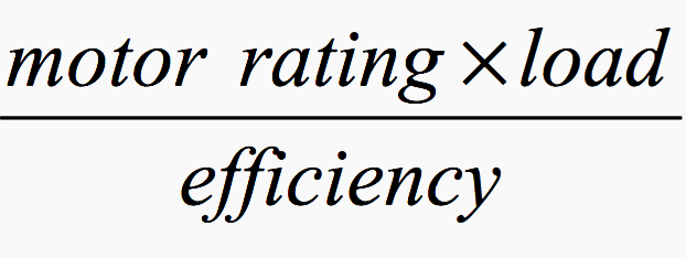

As an example, consider a ventilation fan motor, working full time, at 100 metres from the distribution panel.
Rating kW% LoadOutput Power kWDuty hours/year
7.5876.5258,760
Typical Motor parameters:
EfficiencyOutput PowerInput PowerAnnual ConsumptionCurrent per phase
Comparison[%][kW][kW][kWh][A]
Standard876.5257.5065,7009.84
Energy efficient906.5257.2563,5109.51
The input power is given by the following formula:
The input power formulae
At a unit cost of £0.0443 per unit, the annual saving is £97.02, while the incremental cost of the energy-efficient motor would be about £95.
