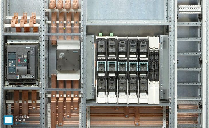

Example for Coordination of Cascaded Circuit Breakers (on photo: Low voltage SIEMENS SIKUS 1600 power distribution board; credit: DirectIndustry.com)

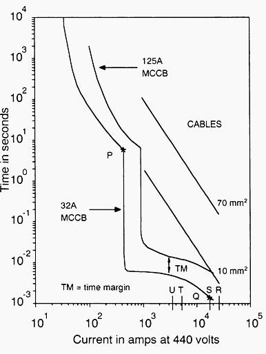

Where Vp is the line-to-neutral voltage. Locate the point R for 26,195 A on the prospective curve in Figure 1.

Locate the point S for 17,443 A on the prospective curve in Figure 1.

Locate the point U for 3473 A on the prospective curve in Figure 1.

12. Find the highest I2t value for the upstream MCCB
Locate two points P and Q on the curve of the upstream MCCB as follows,
PointCurrent in p.u.Current in AmpsTime in secondsI2t
P144066989016.0
Q60217,4500.0016487204.0
Hence I2t at P exceeds that at Q.

16. Plot the results
The results are plotted in Figure 1.
Coordination of MCCBs at a distribution board
Figure 1 – Coordination of MCCBs at a distribution board
