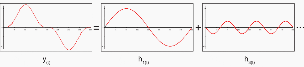

Every periodic signal with a frequency f (regardless of the waveform) consists of the sum of the following:
  • The sine component of the frequency f, known as the fundamental component or h1
  • The sine components of the integral multiples of the frequency f, known as the harmonics hn
  • In some cases DC components can also be present
y(t) = h1(t) + h3(t) …
Figure 1 – Analysing a periodic signal into its component harmonics
Figure 1 - Analysing a periodic signal into its component harmonics

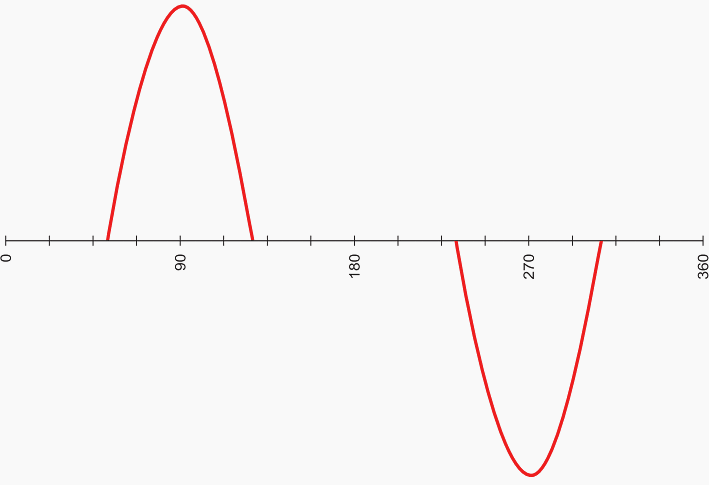

Harmonics can be divided into three categories:
1. Even harmonics (2nd, 4th, 6th, etc.)
Even harmonics (2nd, 4th, 6th, etc.) as a rule only occur due to sudden load variations or faults in converters.
2. Odd harmonics (3rd, 5th, 7th, etc.)
Harmonics divisible by 3 (3rd, 9th, 15th, etc.) occur due to asymmetrical loads and single-phase sources of harmonics. Typical sources are office buildings, hospitals, software companies, banks, etc., factories with 2-phase welding equipment.
The problem they cause: The harmonic currents in the neutral conductor are cumulative.

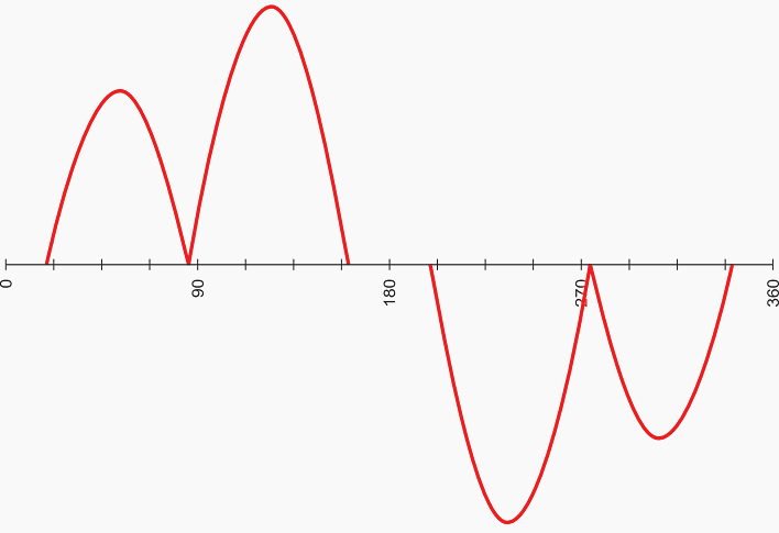

Figure 4 – Current of a power rectifier

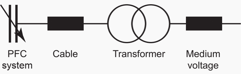

The short-circuit power Sk at the point where the PFC system is connected is:
  • Determined essentially by the transformer (Sn/uk),
  • Reduced by some 10% by the impedance of the medium-voltage system
  • Possibly greatly reduced by long lengths of cable between the transformer and the PFC system.
1.3.1 Example
  • Transformer 1000 kVA, uk = 6%
  • Short-circuit power of the medium voltage system 150 MVA, Sk ≈ 12.6 MVA
  • PFC system 400 kvar in 8 stages, not detuned

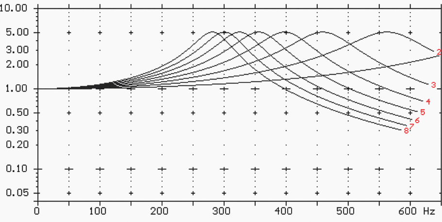

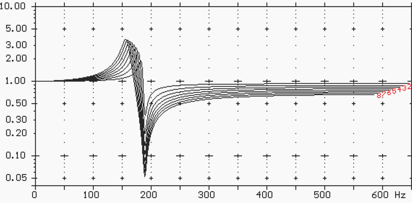

When the capacitor stages of the correction system are switched in, the network resonant frequency (fr) changes considerably and is repeatedly close to the frequency of a network harmonic. If the natural resonance of this oscillatory circuit is near to a network harmonic that is present, it is to be expected that resonance will increase the harmonic voltages.
Under certain conditions, these may be multiplied by an amount approaching the network Q-factor (in industrial systems about 5-10!):
Figure 8 – Amplification factor for harmonic voltages in PFC system without detuning in the low voltage network
1.4 When can dangerous network resonances occur?
From Figure 8 above it can be seen that it is possible to assess whether resonance problems can occur with harmonics. Simple rules suffice for this:
1. If the resonant frequency is:
  • 10% below/above a network harmonic, the latter will be amplified in a network with a high Q-factor (e.g. in the evenings and at night) by a factor of up to 4.
  • 20% above a network harmonic, the latter will be amplified in a network with a high Q-factor by up to 2.5.
  • 30% above a network harmonic, the latter will be amplified only slightly, by a factor of up to about 1.7.
2. In a network with no harmonic generator of its own, but with pronounced harmonics present in the medium voltage system, the following can occur:
  • at a resonant frequency below 400 Hz – resonance peaks of the 7th harmonic,
  • at a resonant frequency below 300 Hz – dangerous resonance peaks of the 5th harmonic (250 Hz).

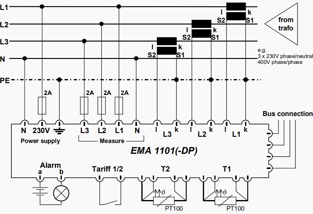

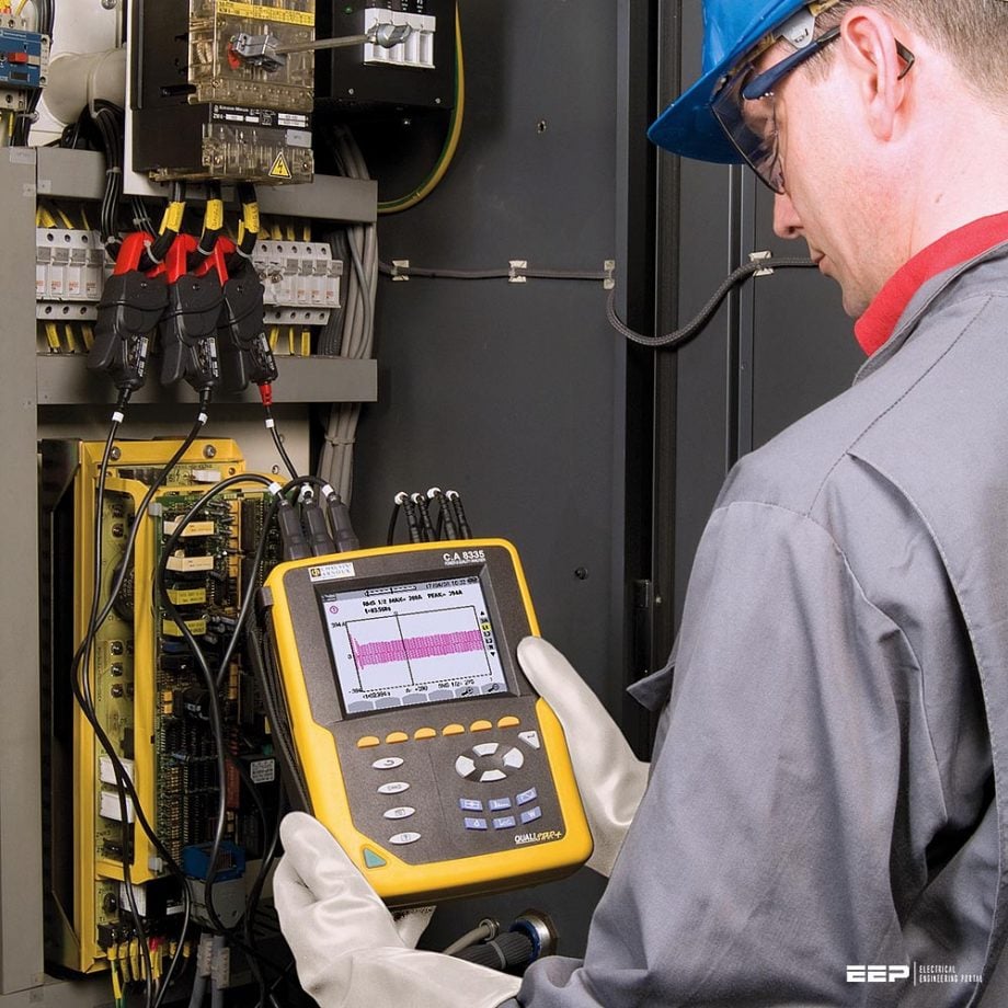

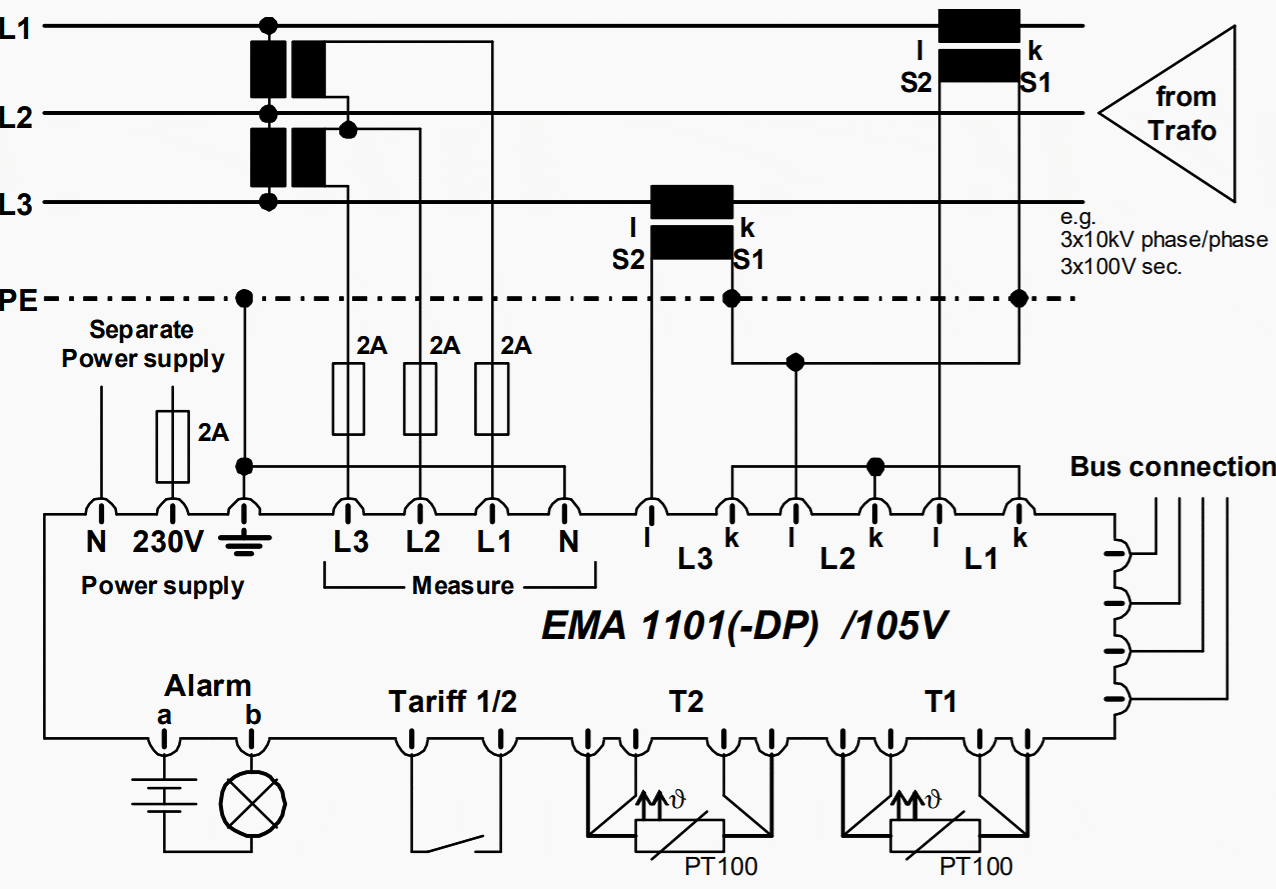

To protect an installation without detuning from the occurrence of resonance, even if this may only happen occasionally, it is highly advantageous to use the Mains Monitoring Instrument. This device monitors all three phases of the power supply system shuts the installation down if a dangerous level of harmonics is exceeded and switches it automatically in again when this level falls below the critical value. Figure 9 shows an example of FRAKO’s mains monitoring instrument, type ‘EMA 1101.
The peak values that have occurred are stored, however, and can be retrieved via the EMA 1101 bus interface.
Figure 9 – Direct connection of Mains Monitoring Instrument to low voltage system
Mains Monitoring Instrument, type 'EMA 1101' by FRAKO
Figure 9 – Direct connection to low voltage system of Mains Monitoring Instrument, type ‘EMA 1101’ by FRAKO manufacturer
Figure 10 – Connection of Mains Monitoring Instrument to medium-voltage system

An average-size low voltage system with a 1000 kVA transformer. The installation, complete with the PFC system, is connected via two 20 m long cables laid in parallel (equivalent to the impedance of a 10 m cable). Only purely ohmic loads may be taken into account as equipment such as induction motors have no damping effect on harmonics.
With a 400 kvar installation and all capacitor sections switched in, the 5th harmonic (250 Hz) is amplified by a factor of about 3. At 250 kvar the 7th harmonic is amplified by a factor of about 4!
During the day, with increased network damping, these factors are lower, but in the evenings and at weekends the amplification factor for the 7th can be higher.
Figure 12 – Amplification of harmonic voltages as a function of the capacitor stages switched in FRAKO – Mains Analysis
Amplification of harmonic voltages as a function of the capacitor stages switched in FRAKO - Mains Analysis

If the level of individual harmonics with no PFC system amounts to more than 1.5% (7th and higher harmonics) or 2% (5th harmonic) and the resonant frequency of the network can be close to these harmonics, then it must be assumed that these permissible limits will be exceeded by resonance-induced amplification. In situations of this type, only detuned PFC systems should be used in order not to jeopardize the reliability of the low voltage distribution system.
Detuning reduces the resonant frequency to a value below 250 Hz. All harmonics above the resonant frequency of the detuned system are attenuated.
Figure 13 – Damping of harmonic voltages as a function of the detuned capacitor sections
A detuned capacitor consists of a capacitor in series with a filter reactor. Its series resonant frequency is adjusted by the appropriate design of the filter reactor so that it is below the frequency of the 5th harmonic (250 Hz). This combination, therefore, has an inductive characteristic for all frequencies above the series resonant frequency.
The resonance between the capacitors and the reactive network impedances is no longer possible. A detuned system suppresses some of the harmonic currents. To prevent overloads due to the 5th harmonic still present in the network, it is a present-day practice to adjust the resonant frequency of the detuned circuit to 189 Hz or less.
The detuned circuit is characterized either by the capacitor-choke resonant frequency (fr) or by the relative voltage drop (p) at the choke. These two parameters are related by the following:
fr = 50 Hz × √(1/p)
