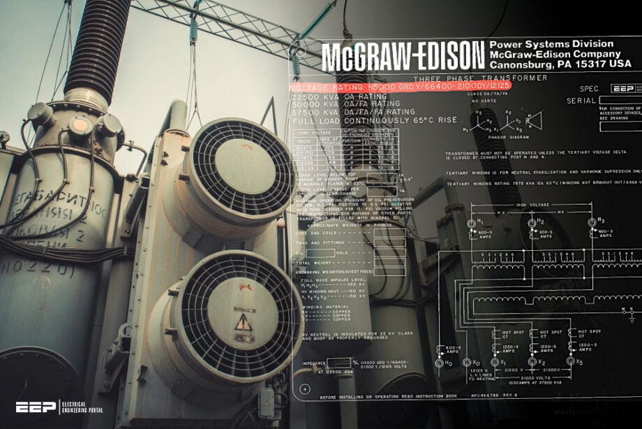

Transformer Nameplate (Birth Certificate)
As we all know, all substation equipment (should) have a metal plate with its “full name and address” on it. Here we’ll discuss transformer nameplate, precisely power and distribution transformers and information that their nameplates carry. A nameplate that provides important details about the transformer’s connection and operation is usually fixed to the tank in an obvious spot.
Learn how to interpret transformer nameplate information
Since the data is frequently engraved or stamped on the nameplate, it is effectively a permanent component of the transformer. Because a transformer nameplate holds so many important details that will follow it for the duration of its service life, it has been considered to a birth certificate.
This technical article analyzes the data presented on the transformer nameplate and provides samples of real transformer nameplate information.

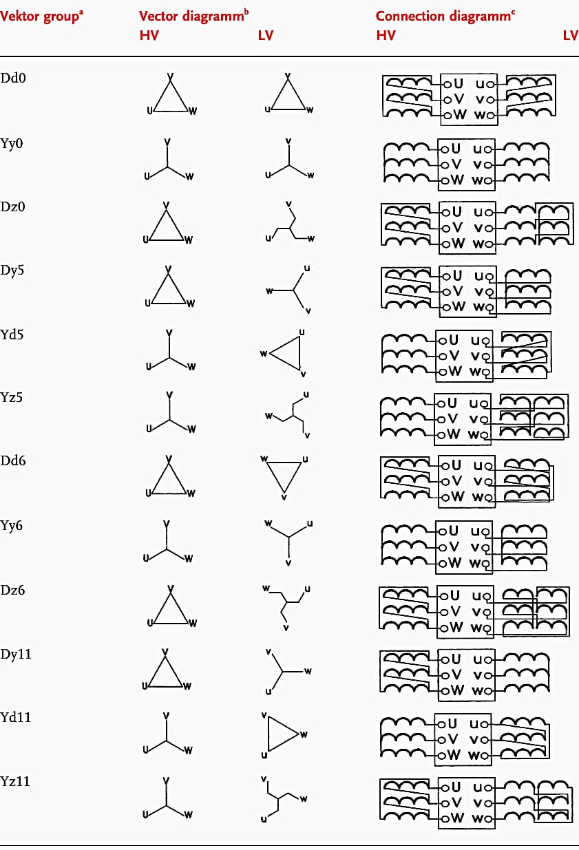

7. Phase Relationships Between the Windings (Vector Diagram)
Transformer windings’ three phases can be connected in a zigzag, delta, or star configuration. The transformer’s nameplate depicts the vector group (star: Y or y; delta: D or d; zigzag: Z or z), with small letters for the windings on the other voltage levels and a capital letter for the side with the highest voltage.
The letters N and n stand for the neutral connection if it is removed from the transformer tank. The corresponding vector group number represents the phase-shift as multiples of 30° of the phase angle of the lower voltage side’s line-to-earth voltages in relation to the corresponding higher voltage side’s line-to-earth voltages (in a mathematically positive sense).
Common vector groups for two-winding transformers are presented in Figure  4.
Figure 4 – Vector group and circuit arrangement of three-phase transformers
Where:
  • a – In case the neutral is brought out of the tank, also include N and/or n.
  • b – 1U, 1V, 1W for the highest voltage; 2U, 2V, 2W and/or 3U, 3V, 3W for lower voltage connections.
  • c – Same direction of coil winding direction starting from connection point.

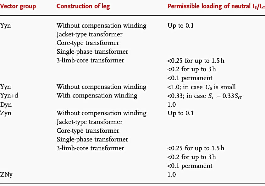

The impedance of the zero-sequence component and the permissible loading of the transformer neutral are significantly impacted by the winding arrangement, whether it be in a star, delta, or zigzag connection. If the neutral is grounded, windings coupled in a star or zigzag pattern have a definite zero-sequence impedance.
The zero-sequence impedance of delta-connected windings with ungrounded star or zigzag connections is infinite.
The ability to carry the rated current of the earthed winding through the neutral, represented as the ratio of the current through earth IE to the transformer rated current IrT, is known as the maximum permissible loading of the transformer neutral.
When the power system is operated with resonance earthing via a Petersen coil or low-impedance earthing, a high maximum allowable loading of the neutral is required.
Low-voltage transformers Yz and transformers with vector groups Yd, Dy, and Yyd (with an extra compensating winding in a delta-connection) offer 100% neutral loading capacity. These transformer types’ zero-sequence impedance to positive-sequence impedance ratio ranges from 0.1 (zero-sequence impedance of z-winding) to 2.4 (Yy with compensating winding in delta-connection).
The specifics of a transformer’s construction determine its X0/X1 ratio. The ratio is X0/X1 = 3–10 for vector group Yy, Yz transformers with a three-leg core; it is X0/X1 = 10–100 for three single-phase transformers or transformers with a five-leg core. The zero-sequence impedance to positive-sequence impedance ratio of low-voltage transformers is typically X0/X1 = 1.
The maximum permissible loading of transformer neutrals for various vector groups and construction types is summarized in Figure 5.
Figure 5 – Maximal permissible loading of transformer neutrals (N or n means that in this case the winding is actually grounded)

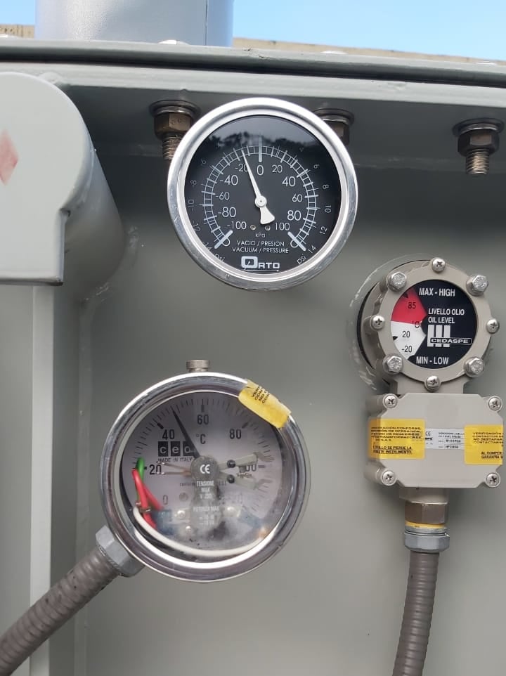

9. Negative Pressure on the Tank
Contemporary power transformers are engineered to be “vacuum oil filled“. Prior to initiating the vacuum process on a transformer, it is essential to examine the nameplate to confirm that the tank is engineered to endure negative pressures. The nameplate also specifies the acceptable range of operating pressures.
The standard atmospheric pressure is 15 psi at sea level. Consequently, when the transformer is in a perfect vacuum, the negative pressure within the tank will be roughly 15 psi at sea level, and marginally lower at higher altitudes.
Figure 6 – Transformer pressure vacuum gauge
Shunt reactor pressure vacuum gauge

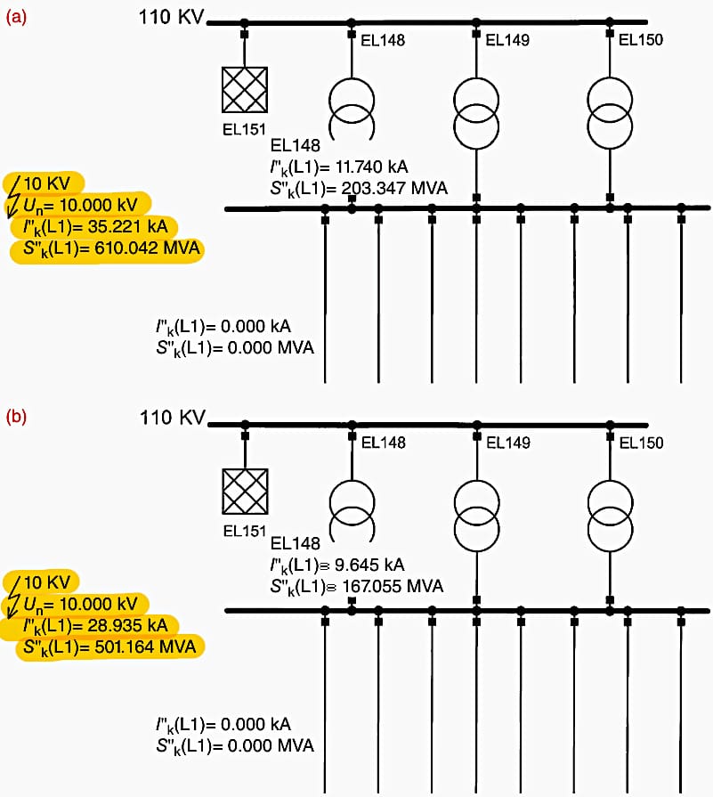

10. Transformer Impedance
Transformers with high impedance voltage reduce the short-circuit level, but the reactive power losses are increased and the tap-changer need to be designed for higher voltage drops.
Figure 7 shows the equivalent circuit diagram of a 10 kV system fed from a 110 kV system by three transformers, SrT = 40 MVA. The system load is SL = 72 MVA, cos ϕ = 0.8. The short-circuit power of the 110 kV system is SkQ′′ = 2.2 GVA; the voltage at the 10 kV busbar is to be controlled within a bandwidth of ±0.125 kV around U = 10.6 kV.
Figure 7 – Equivalent circuit diagram of a 10 kV system with incoming feeder. Results of three-phase short-circuit current calculation. (a) Impedance voltage 13%; (b) impedance voltage 17.5%.

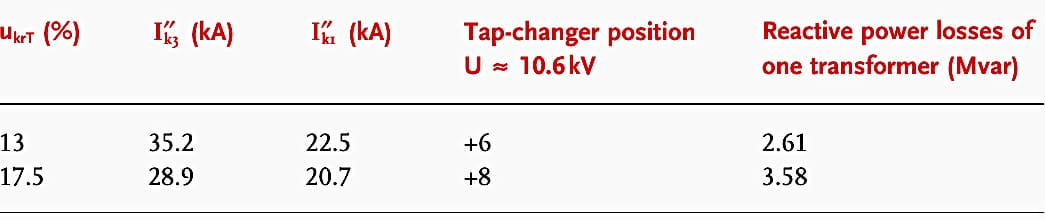

The relevant results of load-flow and short-circuit analysis are outlined in Figure 8.
Figure 8 – Result of load-flow and short-circuit analysis according to Figure 7
As can be seen, the increase of the impedance voltage from 13% to 17.5% reduces the short-circuit current but increases the reactive power losses and increases the number of steps at the tap-changer to control the voltage.
