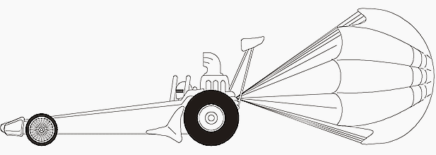

As a result, a motor cannot be braked to a complete stop using dynamic braking. Dynamic braking also cannot hold a load once it is stopped, because there is no more braking action.
For this reason, electromechanical friction brakes are sometimes used along with dynamic braking in applications that require the load to be held, or in applications where a large heavy load is to be stopped. This is similar to using a parachute to slow a race car before applying the brakes.
