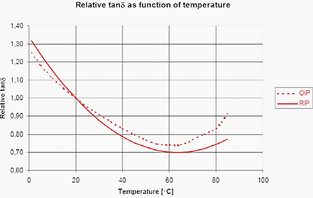

1.4.1 Additional Information for Bushing Diagnostics
The most common technique for assessing the condition of a bushing is the dissipation factor (DF) / power factor (PF) and capacitance measurement. Test results are then compared to nameplate values or previous tests. Increases or decreases from reference values are usually an indication of contamination and/or deterioration of the insulation system.
Limits for the maximum permissible change tend to be manufacturer and type-specific. A doubling of the initial dissipation / power factor value warrants either more frequent monitoring or replacement. A 10 % change in capacitance also warrants replacement.
The temperature of the insulation can affect the dissipation / power factor results. Temperature correction factors for OIP and RIP bushings are shown below in Figure 2. The temperature of the bushing lies between the oil temperature of the transformer and the ambient temperature. The temperature of the oil and the ambient temperature should be recorded in the test report.
Figure 2 – Effect of Temperature on Dissipation / Power Factor (tanδ) Measurement
Leakage currents across the surface of the outer insulator (porcelain or silicone) may also have some influence, particularly if the surface is dirty and wet. In case of unexpectedly high dissipation / power factor values, the bushing should be cleaned before the measurement is repeated. For silicone composite bushings, the cleaning instructions of the manufacturer should be followed, because some cleaning chemicals can damage the silicone.

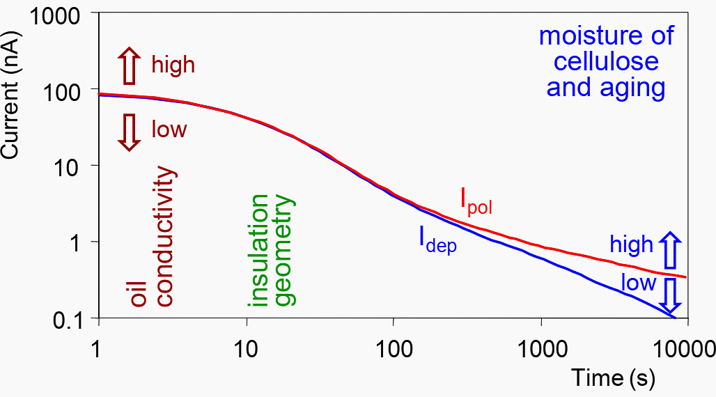

Test Method: The principle of this measurement is to apply a DC voltage across the insulation during a certain time and to measure the polarisation current. Then the insulation is short-circuited at a variable time and the current is measured again (depolarisation current).
Dielectric diagnostic methods deduce moisture in paper or pressboard from the polarization and depolarization currents measured at time intervals. Experience shows that moisture strongly influences these measurements. The dielectric response of insulation can be recorded in the time domain or the frequency domain.
A time-domain current measurement records the charging and discharging currents of the insulation. The derived measurement method is called the Polarization Depolarization Current method.
Figure 3 – Polarisation and Depolarisation Current
Reference: Moisture determination by modelling, comparison to fingerprint measurements
Interpretation: Moisture determination is based on a comparison of the transformer’s dielectric response to a modelled dielectric response. An algorithm rearranges the modelled dielectric response and delivers moisture content and oil conductivity.
A reliable moisture analysis of on-site measurements is based on an exact data pool for the modelled dielectric response. The data pool includes the measurements on the new pressboard at various temperatures, moisture contents and oils used for impregnation. Once water content has been assessed, refer to the limits for dry, moderately wet and extremely wet insulation provided in IEC 60422.
Comments and Suggestions: New procedures consider also the dielectric properties of aged pressboard in order to compensate for the influence of ageing.

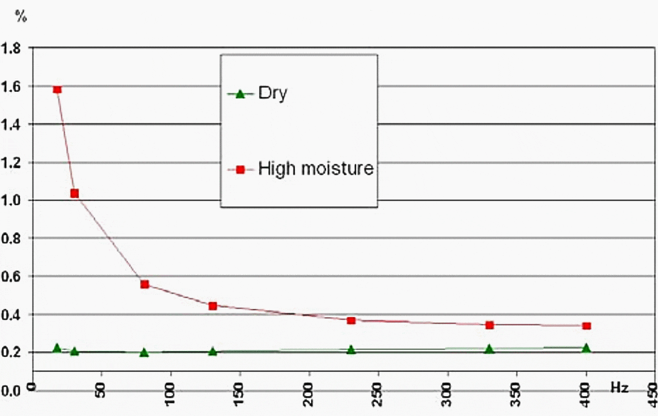

Test Method: The principle of this measurement is the same as Capacitance and Dissipation / Power Factor described previously but differs by being applied at different frequencies, typically from 0.001 Hz to 1000 Hz as shown in the following traces:
Figure 4 – Frequency Domain Spectroscopy
Reference: Moisture determination by modelling, comparison to fingerprint measurements, limits for dry, moderately wet and extremely wet insulation are given in IEC 60422.
A reliable moisture analysis of the on-site measurements is based on matching them with a data pool for the modelled dielectric response. The data pool consists of measurements on the new pressboard at various temperatures, moisture contents and oils used for impregnation. New procedures consider also the dielectric properties of aged pressboard as well in order to compensate for the influence of ageing. Once water content has been assessed, refer to the limits for dry, moderately wet and extremely wet insulation provided in IEC 60422.
Comments and Suggestions: The combination of time-domain polarization current measurements with frequency-domain spectroscopy reduces the test duration compared to existing techniques.
Essentially, time-domain measurements can be accomplished in a short time but are limited to low frequencies (typically below 1 Hz). In contrast, frequency-domain measurements are feasible for high frequencies as well but take a very long time at low frequencies.
In its application to high voltage bushings, the measurement of Dissipation / Power Factor at low frequencies (some Hz) enables the detection of moisture with high sensitivity. Figure 16 below demonstrates the typical moisture sensitivity of the Dissipation / Power Factor Measurement on OIP bushings between 20 Hz and 400 Hz.
Figure 5 – Dissipation / Power Factor Measurement on OIP Bushings at Different Frequencies
As a guide, indicative limits for Dissipation / Power Factor in new and aged bushings at frequencies of 15 Hz, 50/60 Hz and 400 Hz are given in the following table.
Table 2 – Indicative DF/PF Limit Values for Condenser Bushings
