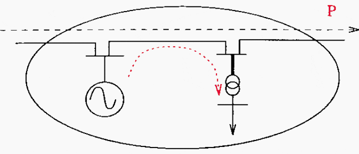

1.1 Voltage drops
Let us consider the trivial electrical model according to Figure 1, where a synchronous generator G feeds a load through a transmission line represented by a single series impedance ZL= R + jX, with the load power being S = P + jQ.
Considering that when the voltage profile is fair, the voltage is not too different at the two ends of the line, and that the power transmission angle ψ is small (ψ = difference of voltage angles at the two ends of the line), we find the well known voltage drop along the transmission line:
ΔV = [(RP + XQ) + j(XP – RQ)] / V2
Which may be shared into two components:
  1. a voltage drop in phase with V2, equal to: (RP + XQ) / V2
  2. a voltage drop in quadrature with V2, equal to: (XP – RQ) / V2
Figure 1 – Basic transmission system model
Seen from any system operator or from (almost) any protection device, the estimation of the voltage is based on the measurement of the voltage magnitude, so the component in phase has to be considered at first approximation.
And from the very simple equations above, we may find interesting clues for both planning, operational, protection, static and dynamic aspects, because we want low voltage drops:
Clue #1 – We must look for high voltage profile, well sized transmission network between generators and loads, low reactive power consumption at load level.
Clue #2 – Dynamic aspects are very important to take into account, because all the parameters of the formula are liable to vary in real time: consistency of the transmission link between generators and loads (owing to topology changes or to line trips), consumption of the load (variations of the load demand, sensitivity of load to voltage…), voltage profile.
Clue #3 – and we must also remember that the values of the voltages ate not a perfect modelling of the reality.
This brings effects on operators and protection devices: voltage magnitudes are generally considered and not phasors, and technology considerations may cause many imperfections: the different voltages received at time t by the operators and protection devices may represent voltages which in fact have been measured at different times and altered by imprecisions.
Let us remember that 1% error at measurement level represents 4 kV for a 400 kV voltage, which is quite high when we have to control voltage in a narrow range, let us say between 380 and 420 kV in normal conditions.

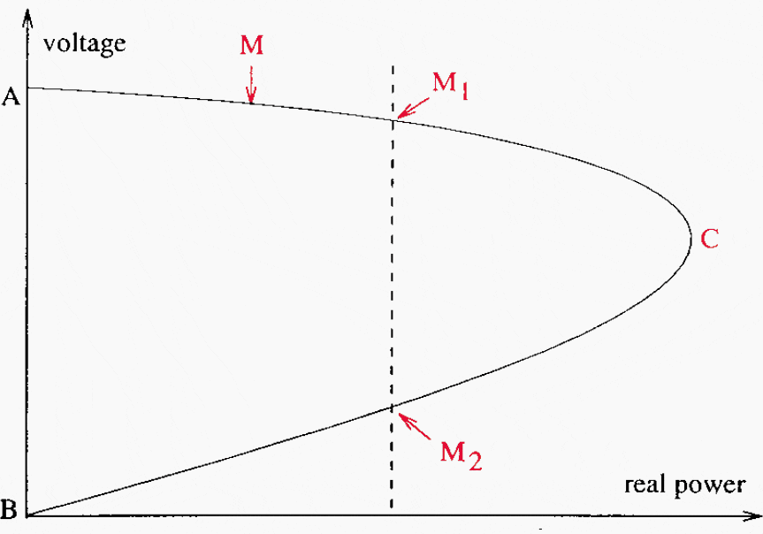

When the voltage level is left uncontrolled at load level, we also know from technical literature that we can plot the well known “P-V curve” describing the relationship between the real power which may be delivered to the load and the voltage of the load, see Figure 2.
This curve may also be considered as plotted as a function of the value of the load resistance, with point A being infinite resistance and point B being zero resistance; if the emitting voltage remains constant and if the value of the load resistance varies from infinite value to zero, the operating point M will follow the curve from A to B.
At the “critical point” C, we have the maximum of real power transmitted to the load.
Figure 2 – The P-V curve for a transmission system
For a given value of real power supplied to the load, there seems to be two possible operating points M1 and M2. In fact the part of the P-V curve which is below the critical point C does not correspond to satisfactory operation. At point M2, for the same real power flow, the voltage of the load is much lower, the load current and the losses are much higher.
If the consumers are supplied through transformers with On-Load Tap-Changers (OLTCs), the behaviour of these OLTCs will not be small-disturbance stable.
For instance the OLTCs will try to raise the voltage at the terminals of the load by changing the tap of the transformer. It will have the effect to reduce the apparent impedance of the load seen from the system, and thus to lower again the voltage; then the OLTCs will continue to change taps, and the process will continue into a voltage collapse until the OLTCs reach their ultimate taps.
Thus it can roughly be said that the lower part of the P-V curve is unstable (of course, reality is more complex and a precise description needs to consider the intersections of the P-V curve and of the curve representing the characteristics of the load). Obviously it is necessary to keep the operating point distant enough from the critical point C.

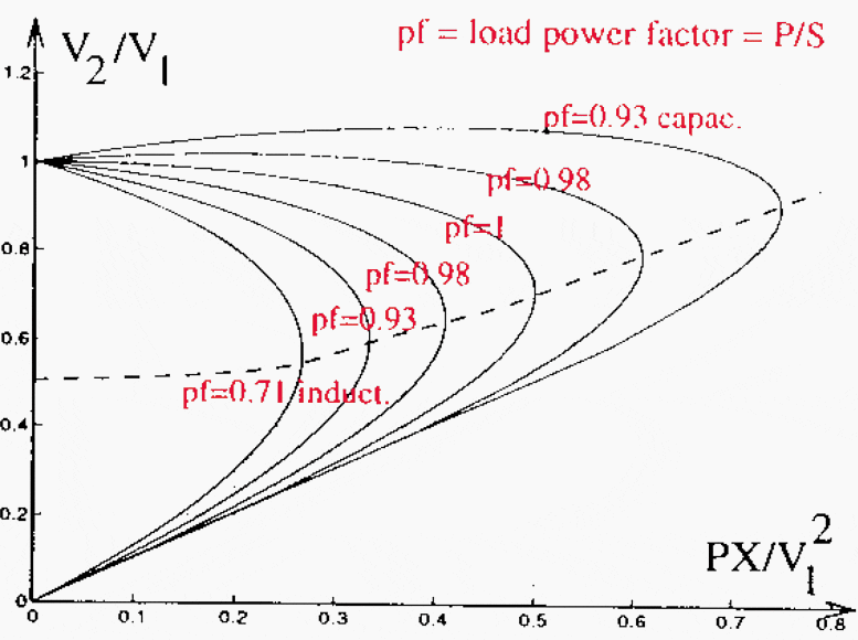

Figure 4 – Change of P-V curve due to load power factor

Observation #4 – The characteristic of the load has a strong effect. Improvement of the load power factor through compensation enables the system to reach higher transmission capacities.
But there is an adverse effect: insertion of shunt capacitors leads to an upper part of the P-V curve which is very flat, and so the value of the voltage becomes a very poor indicator of the proximity to voltage collapse. It also moves the critical voltage point towards the rated voltage.

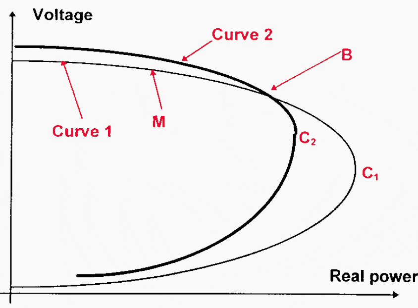

Let us suppose now that we are in the early morning and that the load begins to increase, with the starting of domestic and industrial activities.
The situation is fairly good for the power system, as we have two buses (1 and 2) where the voltage is maintained constant, and the operating point M, in Figure 6, drifts slowly towards the right on Curve 1 representing the situation with constant voltages at Buses 1 and 2; there is a fair distance to the maximum transmission capacity (critical point C1).
As the load continues to increase, generator G1 has to produce more reactive power; finally, G1 reaches the limits of its reactive reserves (operating point B), and so the voltage cannot any more be maintained constant at Bus 1.
Now the operation point follows Curve 2 representing the situation where the voltage is constant only at Bus 2. This is a strong non-linearity; whereas the distance to maximum transmission capacity was from point B to point C1, it is now only from point B to point C2. If the load continues to increase, and if no action is taken very fast, it may come into a voltage collapse.
Now it may be seen that protection against voltage collapse involves careful studies from planning stage to real time.
Figure 6 – P-V curves for different modes of operation according to Figure 5
