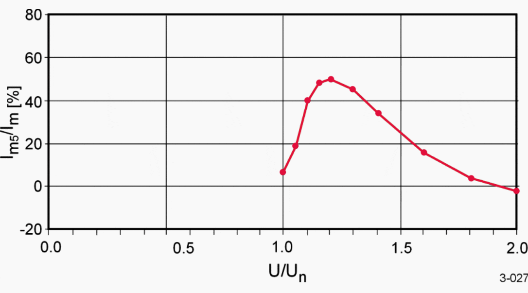

The increasing magnetizing current has a high content of the fifth harmonic, which can be used to detect the phenomena. The following figure demonstrates the issue and the behavior of a certain power transformer.
The fifth harmonic content in magnetizing current as a function of supply voltage
Figure 3 – The fifth harmonic content in magnetizing current as a function of supply voltage
The phenomenon related to an increasing magnetizing current as a result of increasing supply voltage is referred to as over-excitation.

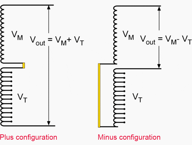

Out of these three, the first one, plus-minus switching, is the most common. The operation principle is shown below.
Tap changer’s "plus-minus switching" principle
Figure 4 – Tap changer’s “plus-minus switching” principle
Typically, the on-load tap changer is motor-operated, providing a possibility for remote control. The off-load tap changer is most commonly having manual operation facilities only, but also a motor operation is possible.
The on-load tap changer has a number of taps, like ±8×1.25%. This indicates a possibility of an 8-step, each 1.25%, increase or decrease from the rated voltage ratio. The off-load tap changer has fewer steps, like for example ±2×2.5%.

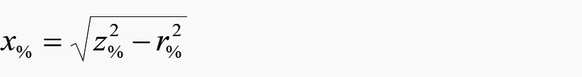

As noted earlier, the short circuit impedance Z is a complex number having a real and an imaginary part.
The real part of the impedance can be calculated based on the rated load losses PL [W]. The following formula gives the result in percent r% [%].
Percent r [%] formulae
The imaginary part x% [%] can be calculated as follows:

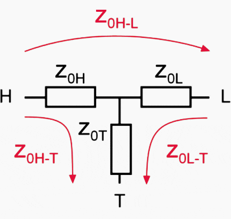

6. Transformer Sequence Impedances
Here are introduced the sequence impedances related to power transformers. The following definitions are used:
  • Z1 is the positive-sequence impedance [Ω/phase]
  • Z2 is the negative-sequence impedance [Ω/phase]
  • Z0 is the zero-sequence impedance [Ω/phase]

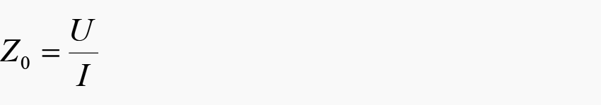

Zero-sequence measurement
Figure 7 – Zero-sequence measurement
The following equation below can be used to calculate the zero-sequence impedance Z0 [Ω/phase] using voltage U [V] and current I [A] as defined in Figure 7 above.
Zero-sequence impedance Z0 [Ω/phase]
With transformers:
Zero-sequence impedance with transformers
The positive- and negative-sequence impedances equal the short circuit impedance, whereas the zero-sequence impedance differs considerably.

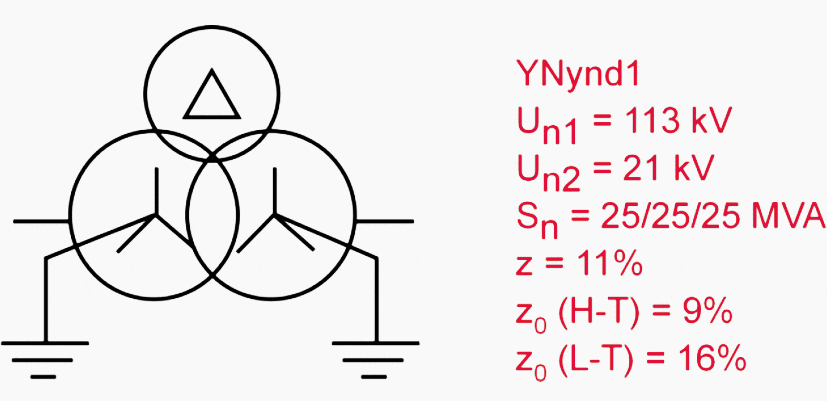

Zero Zero-sequence impedances of Yzn- and YNynd-connected power transformers as a relation to the units’ short circuit impedance
Figure 10 – Zero Zero-sequence impedances of Yzn- and YNynd-connected power transformers as a relation to the units’ short circuit impedance

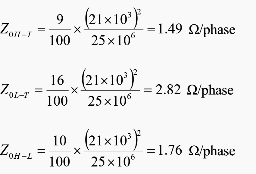

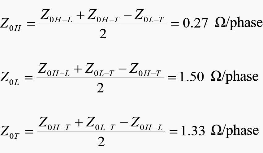

Normal procedure for the power transformer manufactures is to state the zero-sequence impedance in relative values, either as a fraction or a percentage of the reference impedance.
For calculating the actual ohmic values, the same equations as introduced for the short circuit impedance calculations can be used.
With transformer connection groups allowing the closed loop for zero-sequence current to circulate, like YNd, the real and imaginary parts of the zero-sequence impedance have the same relation (ratio of R/X) as with the corresponding short circuit impedance. With other connection groups, the situation is more complicated, while the R/X ratio is not necessarily linear.
For three-winding power transformers, the calculation of zero-sequence impedance ohmic values is a bit more complicated.
In this example, the following information is available in the power transformer’s data sheets.
Data for the power transformer used in calculation example
Figure 11 – Data for the power transformer used in calculation example
The following figure shows the zero-sequence impedance components whose ohmic values should be calculated based on the above data.
It is assumed here that the impedances are pure reactance, and the chosen reference voltage is 21 kV (low-voltage side of the transformer).
Zero-sequence circuit of the transformer used in the example
Figure 12 – Zero-sequence circuit of the transformer used in the example
Calculation of the ohmic values based on the transformer’s given data:
Ohmic values based on the transformer’s given data
The specific component impedances are then calculated.
Specific component impedances
