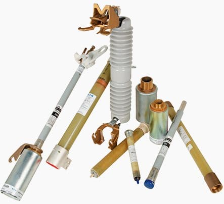

EATON's medium voltage expulsion fuses
EATON’s medium voltage expulsion fuses provide full-range fault protection for both indoor and outdoor, medium voltage distribution systems

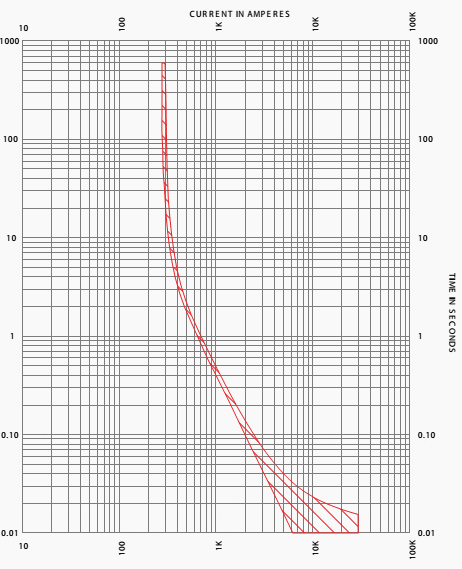

The fuse in Figure 1 is a 125E-rated fuse. Note that the curve starts at approximately 250 A for a minimum melting time of 1000 s.
Care must be taken with backup and general-purpose current-limiting fuses so that the load current does not to exceed the E- or R-rating of the fuse. Failure to do this can result in the development of a hot-spot and subsequent failure of the fuse and its mounting. For fuses enclosed in equipment, this can have disastrous consequences since failure of the fuse and/or its mounting can lead to an arcing fault in the equipment.
Note that the boundary of the characteristic, denoting the minimum-melting current, should be further derated to take into account pre-loading of the fuse (consult the fuse manufacturer for details). Note that, as with low voltage fuses, the current-limiting fuse characteristic does not extend below .01 seconds since the fuse would be in its currentlimiting range below this interrupting time.
Typical E-rated current-limiting power fuse time-current characteristic
Figure 1 – Typical E-rated current-limiting power fuse time-current characteristic

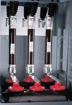

A current-limiting power fuse consists of a fuse mounting (typically fuse clips) plus the fuse unit itself. These are frequently mounted in metal-enclosed switchgear. A distribution current-limiting fuse may consist of a disconnecting-style holder or clips, plus the fuse unit. Distribution current-limiting fuses may also be provided with under-oil mountings for use with distribution transformers.
They are frequently used for capacitor protection as well, with clips designed to mount to the capacitor.
Current-limiting power fuses and mountings
Figure 2 – Current-limiting power fuses and mountings
Current-limiting power fuses are typically used for short-circuit protection of instrument transformers, power transformers, and capacitor banks. Table 1 below gives maximum ratings for medium voltage current-limiting power fuses from 2.75 through 38 kV.

Medium voltage boric acid expulsion fuses
Eaton’s BA/DBA Power Fuses are medium voltage boric acid expulsion fuses that offer double protection for circuits and equipment which operate on voltages from 7.2 to 145 kV. They carry the boric acid principle of circuit protection to higher voltage ratings, and at the same time provide at lower cost short-circuit protection for systems of moderate capacity.
Power expulsion fuses generally consist of an insulating mounting plus a fuse holder which accepts the fuse refills. The fuse holder may be of the disconnecting or non-disconnecting type. Only the refill is replaced when a fuse interrupts an overcurrent, and if only one phase of a three-phase set interrupted the fault only that fuse need be replaced.
Power expulsion fuses are typically used in substations and enclosed equipment.
Distribution expulsion fuses are generally distribution fuse cutouts, which are adapted to pole or cross arm mounting. They consist of the fuse holder and refill unit. The fuse holder is usually of the disconnecting type. These are typically used as pole-mounted fuses on utility distribution systems.
Expulsion fuses use the liberation of de-ionizing gasses to interrupt overcurrents. Boric acid is typically used as the interrupting medium for power expulsion fuses and bone fiber is typically used for distribution fuse cutouts. When an expulsion fuse interrupts an overcurrent the interrupting medium liberates de-ionizing gas, interrupting the overcurrent.
The exhaust gasses are then emitted from the fuse, accompanied by noise. The exhaust gasses for a boric acid fuse may condensed by an exhaust control device (commonly called an exhaust filter, silencer, or snuffler).
