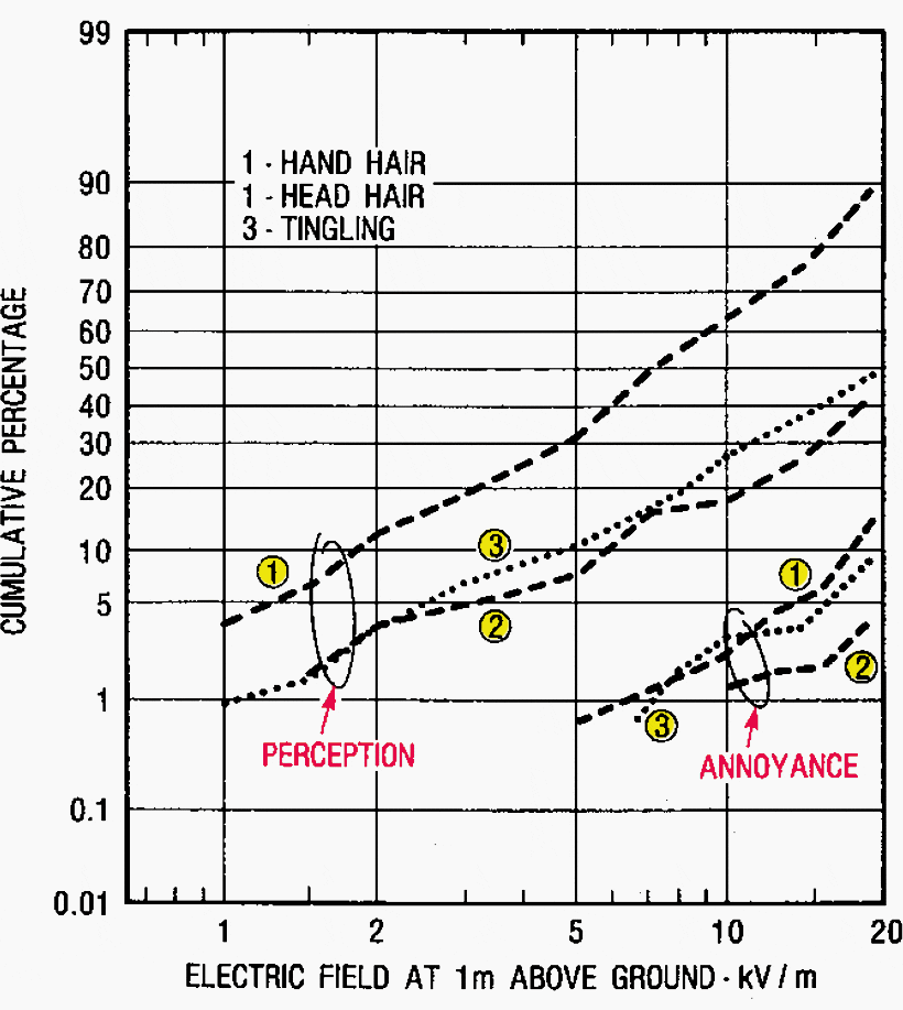

The results, presented in Figure 2 below, show the percentage of people who experienced sensations above the threshold of perception and above the minimum annoyance level.
Combination of all results obtained on perception and annoyance of hair erection and tingling (136 persons)
Figure 2 – Combination of all results obtained on perception and annoyance of hair erection and tingling (136 persons)
The curves marked with a 1 correspond to stimulation of the hair of the hand, with the subject’s arm extended over the head searching for the position where the sensation is strongest. Curve 2 corresponds to stimulation of the hair of the head (forehead, eyebrows, sideburns), with the subject’s arms at the side of the body.
Curve 3 corresponds to a tingling sensation in parts of the body covered with clothes (elbow, shoulder, sides).

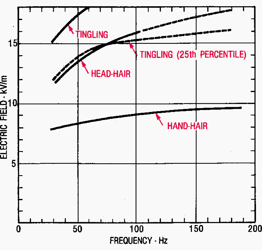

The frequency of the electric field has an effect on the sensation.
Median values of threshold of perception of hair sensations of people as a function of the frequency of the electric field
Figure 3 – Median values of threshold of perception of hair sensations of people as a function of the frequency of the electric field. For “tingling” the 25th percentile also is given.
Results of Project UHV tests performed with different frequencies are shown in Figure 3.
The data indicate a greater sensitivity at lower frequencies. The difference between the effects of 50-Hz and 60-Hz fields is very small and insignificant when com-pared with the large dispersion of these data.

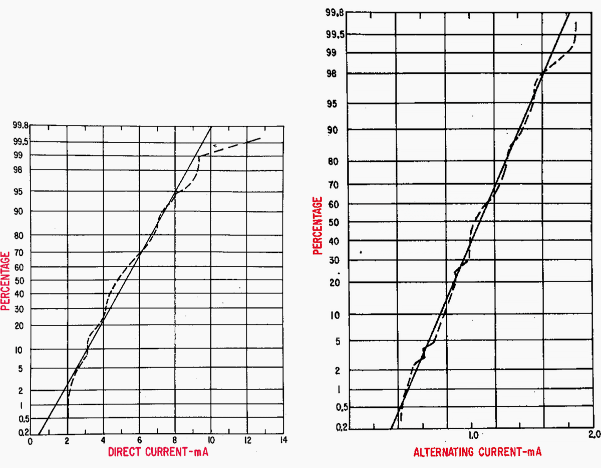

Experimental results from Mr. Dalziel (professor of electrical engineering and computer sciences at UC Berkeley) are shown in Figure 4 for direct current and in Figure 5 for alternating current.
The data follow a normal distribution with large dispersion (ratio 1 to 4 between 1% and 99% values) with average values for men equal to 5.2 mA for direct current and 1.1 mA for 60-Hz alternating current.
Distribution curve of minimum direct and alternating current
Figure 4 – Distribution curve of minimum direct current perceptible data from tests on 115 men; Figure 5 – Distribution curve of minimum alternating current perceptible. Data from 167 men
The first sensation for direct current is that of heat, whereas the first sensation for alternating current is a stinging sensation. Insufficient data are available for women.

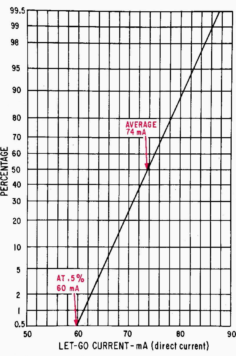

Figure 6 shows the distribution curve of let-go values for different currents.
Distribution curve of let-go value of direct currents
Figure 6 – Distribution curve of let-go value of direct currents. Data from tests on 28 men.

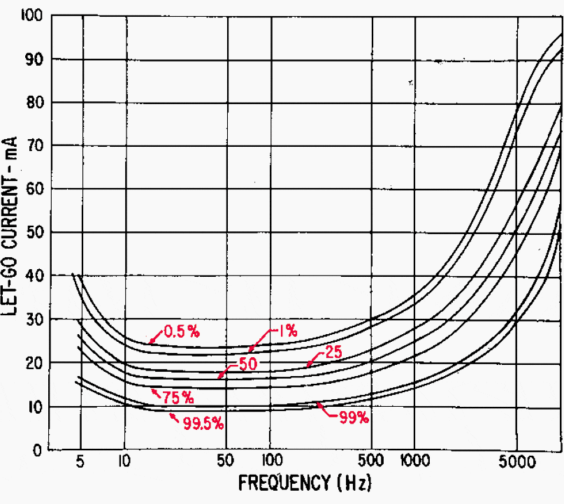

The influence of frequency on let-go current is shown in Figure 8 below. Increasing the value of the current above let-go might pro-duce ventricular fibrillation.
Effect of frequency on let-go current
Figure 8 – Effect of frequency on let-go current. The curves re-fer to different percentages of the population for which the let-go conditions are reached.

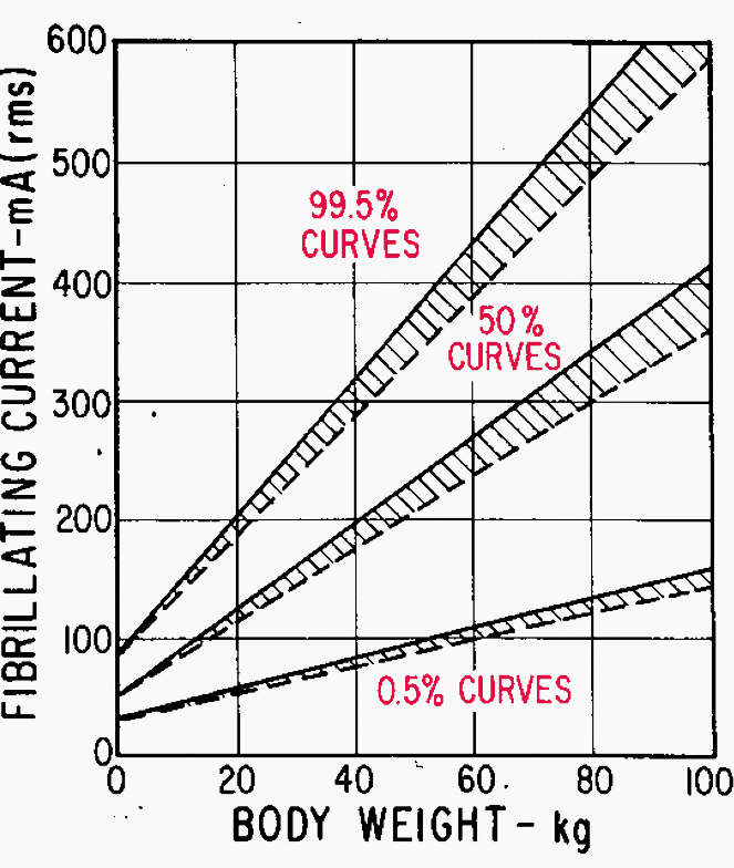

Fibrillating current values are shown in Figure 9 as a function of body weight for different species of animals. The parameters influencing ventricular fibrillation are body weight, current magnitude, and shock duration.
Dalziel investigated the relation between current and time and proposed an electrocution equation:
i = k / √t
(i in mA, t in seconds).
For a probability of 0.5%, k=165.
Fibrillating currents versus body weight for six species of animals (calves, dogs, sheep, cats, rabbits, guinea pigs)
Figure 9 – Fibrillating currents versus body weight for six species of animals (calves, dogs, sheep, cats, rabbits, guinea pigs). Continuous curves: all animals considered, Dashed curves: guinea pigs omitted.

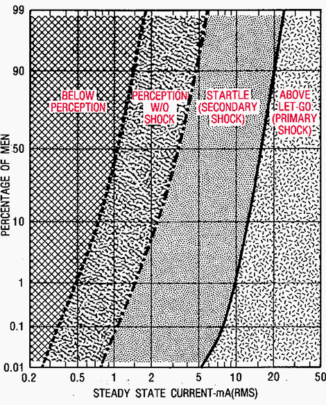

A summary of the response of adult men to steady-state ac electric currents is shown in Figure 10. The fewer data available for women indicate levels approximately two-thirds of those for men. Data for children are nonexistent.
Let-go values for children for a probability of 0.5% have been conservatively estimated as equal to 5 mA.
Statistical distribution of responses of adult men to steady-state AC currents through a gripped contact
Figure 10 – Statistical distribution of responses of adult men to steady-state AC currents through a gripped contact
