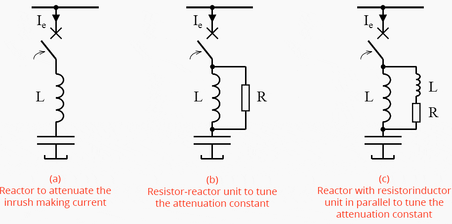

4. Measures to limit the inrush making current
There are two possible ways to reduce a high inrush making current and to move it into the permissible region:
  1. The limitation of the inrush current to ≤ 10 kA (or ≤ 5 kA) by means of a reactor.
  2. The reduction of the time constant (attenuation constant) by means of a resistor-inductor unit in parallel with the reactor. However, this measure is only convenient for existing reactor-capacitor units.

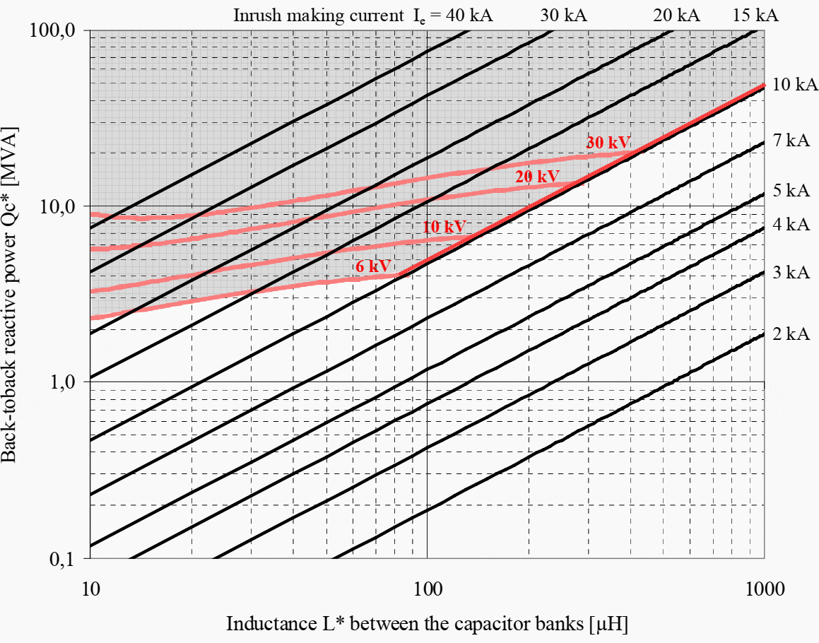

For a given reactive power and inductance between the capacitor banks, the inrush making current on back-to-back switching can be read from the graphs (Figure 2). If the inrush current is too high, the diagram shows the inductance which is required to keep the inrush current below the limit.
Figure 2 – Back-to-back inrush making current of two capacitor banks, depending on the inductance between the banks
The difference between the existing and the required inductance should be installed as an additional reactor; see (a), Figure 3. The red borderlines (Figure 2) mark the area (grey) for 6 kV to 30 kV operating voltages within which the attenuation constant of the inrush-making current is too high. For these borderlines, a Q-factor (quality factor) 60 of the parallel oscillating circuit is presumed.
The back-to-back reactive power results from the series connection of the two capacitor banks (Figure 1).
Qc* = (Qc1 × Qc2) / (Qc1 + Qc2)
The inductance between the capacitor banks consists of the inductances of the connecting conductors and the switchgear assembly. The following values can be presumed: for L1 and L2 insert the values of the relevant cables/bars (in the range of ca. 0.3 … 0.7 µH/m).
L* = L1 + L2 + Ls
For each functional unit (panel) of the switchgear assembly insert 2 µH for the busbar, and 5 µH for the two feeders (including current transformers); n = number of functional units (panels) between the capacitor bank feeders.
Ls ≈ 5μH + n × 2μH
Figure 3 – Methods to limit the inrush making current
A reactor that can be freely selected (Figure 3a) is the easiest method to limit the inrush-making current. In the case, a reactor is already installed or planned but the inrush current is still too high, a resistor in parallel (Figure 3b) can tune the attenuation constant.
The resistance, however, may vary in a small range only. It must neither be too high (to be efficient) nor too low (to avoid thermal overload of the resistor). An L-R impedance in parallel to the reactor (Figure 3c) facilitates more exact tuning.
In any case, the damping elements need to be individually planned for the given installation.

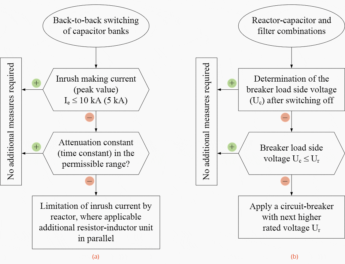

7. Check for permissible stress on the circuit-breaker
If the back-to-back inrush making current is below the permissible peak values or the attenuation of the current is strong enough, no additional measures are required. Otherwise, a detailed assessment as described in Section 4 (Measures to limit the inrush making current) has to be carried out.
With filters or reactor-capacitor units, the voltage on the load side of the circuit-breaker must not exceed the rated value at the instant of switching off.
There is a particular danger if the operating voltage of the system is very close to the rated voltage and at a low ordinal number of the harmonics.
Figure 5 – (a) Inrush current check; (b) Voltage check
