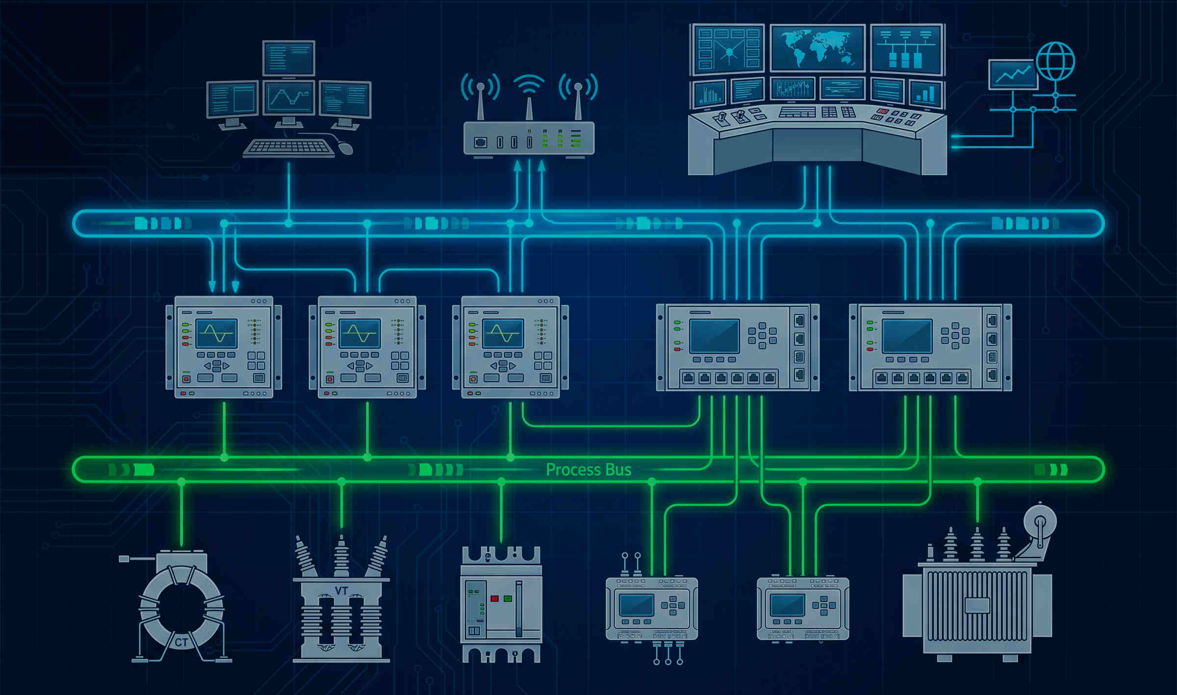

This course introduces the IEC 61850 series of standards as the modern communication and data‑modelling framework for substation protection, control, and monitoring systems. Starting from the limitations of traditional hard‑wired and vendor‑specific solutions, the course explains the objectives and architecture of IEC 61850, including station‑bus and process‑bus concepts, logical devices and logical nodes, and the standardised naming of data objects and attributes.

  2. Describe the typical IEC 61850 substation architecture, including station level, bay level, and process level, and distinguish between station‑bus and process‑bus applications.
