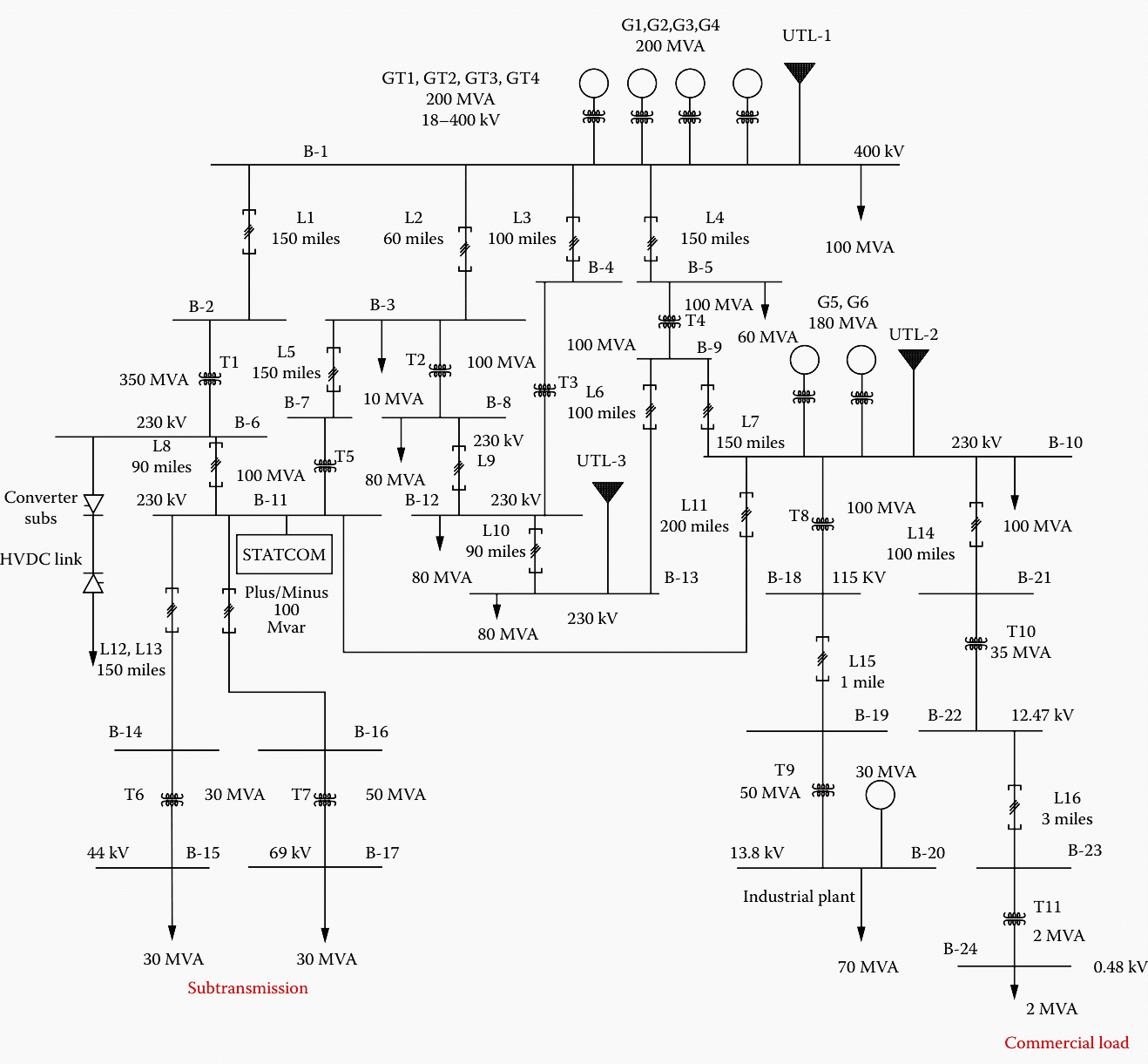

To comprehensively understand how electric power is delivered to LV substations, you will need to track the source of electricity going through the stages of its delivery. Electricity passes through three stages: generation, transmission and distribution.
Electricity is first generated in power plants or stations with a voltage of 11kV, then stepped up using step-up transformers to increase the voltage to between 100 kV to 700kV depending on the distance it will be transferred to; the longer the distance, the higher the voltage.
After that, electricity is transmitted via overhead electrical lines, which you can see when you drive between cities (see bottom for ‘Commercial load’).
Figure 1 – A 24-bus system, showing generation, transmission, subtransmission, industrial, and commercial loads
The transmission of these lines is aimed at reaching several receiving HV substations. When electrical power reaches a receiving station, the voltage decreases to 33kV and 66kV. It is then sent to transmission lines from this receiving station to electrical substations close to cities, villages, and urban areas. When electrical power reaches a substation, it is stepped down once more by a step-down transformer to voltages closer to what it was generated at, usually around 11kV.

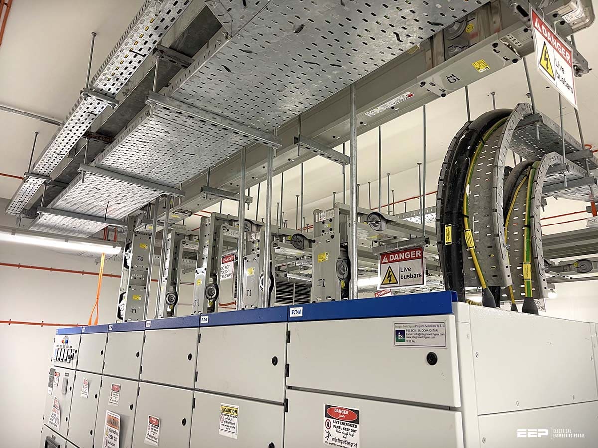

Designing the LV part of an LV substation can only be done by taking some considerations in mind. The 11kV/0.45kV substation can either be located indoors or outdoors. The most likely type of LV substation used for supplying customers with less than 500V is located inside the building and distributes power to the entire project, and should be designed to meet the safety requirements to avoid any dangerous situations.
The LV substation MUST be designed to provide a reliable service, facilitate maintenance and allow for future expansions.
In other words, at least 20% spare capacity should be provided for every equipment inside the room, including cable trays, trunks, LV switchboards, etc. Below are some major requirements that must be complied with inside an LV substation.

2.1. Equipment Clearances You MUST NOT Be Wrong About
The internal clearances of an low voltage room must always follow international standards like NEMA, BS and NFPA. Equipment such as trays, LV switchgear, capacitor banks etc., are usually located and placed following these standards. In many countries, LV substation design drawings are be approved by the main electrical authority before building construction.
This is why dimension considerations must be made during the design stage.
Electrical authorities might only supply the building with power if the requirements are met. In a typical LV substation, cable trays are installed to facilitate the outgoing and incomer cables. These trays should be designed to be located with sufficient clearances around them to permit adequate access for the installation and maintenance of cables.
