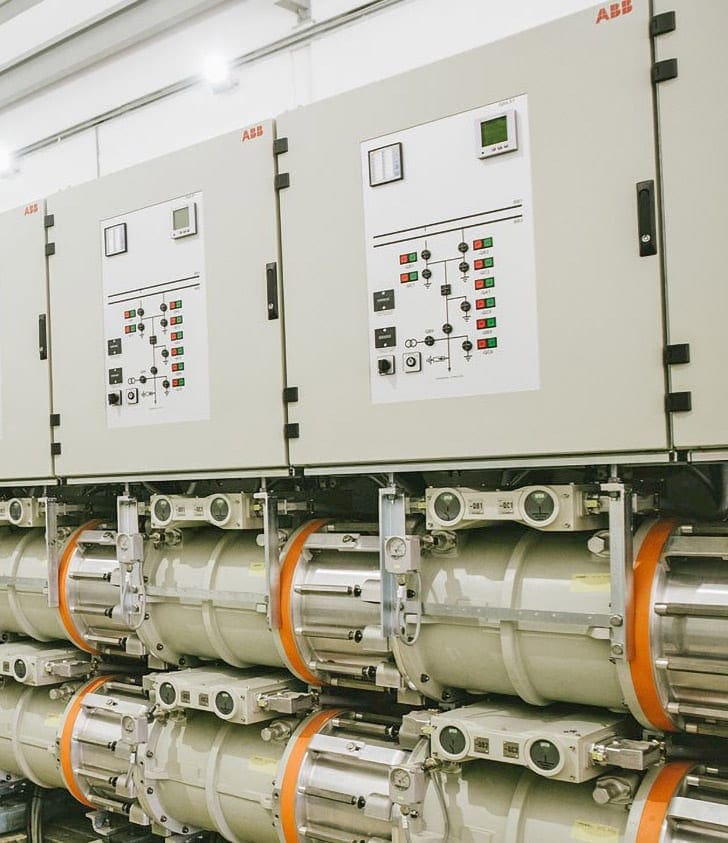

Gas-insulated switchgear (GIS) is a piece of high voltage equipment that is being constantly developed day by day. The basics of GIS technology is more or less the same, but everything else under the hood is improved a lot comparing to just a few years ago. This article explains major GIS components and their characteristics.
Major components you can spot while looking at HV/EHV GIS (Gas-insulated switchgear)
GIS are available internationally, covering the complete voltage range from 11 kV to 800 kV. The thermal current-carrying capacities and the fault-withstanding capabilities are tailored to meet all the substation requirements. More than 200,000 GIS bays have been in service all over the world since the introduction of such substation systems in the transmission and distribution field.
High voltage substation generally consists of many sections/bays. The main equipment in a section consists of circuit breakers, isolators or disconnect switches, earth switches, current transformers, surge arresters, etc.

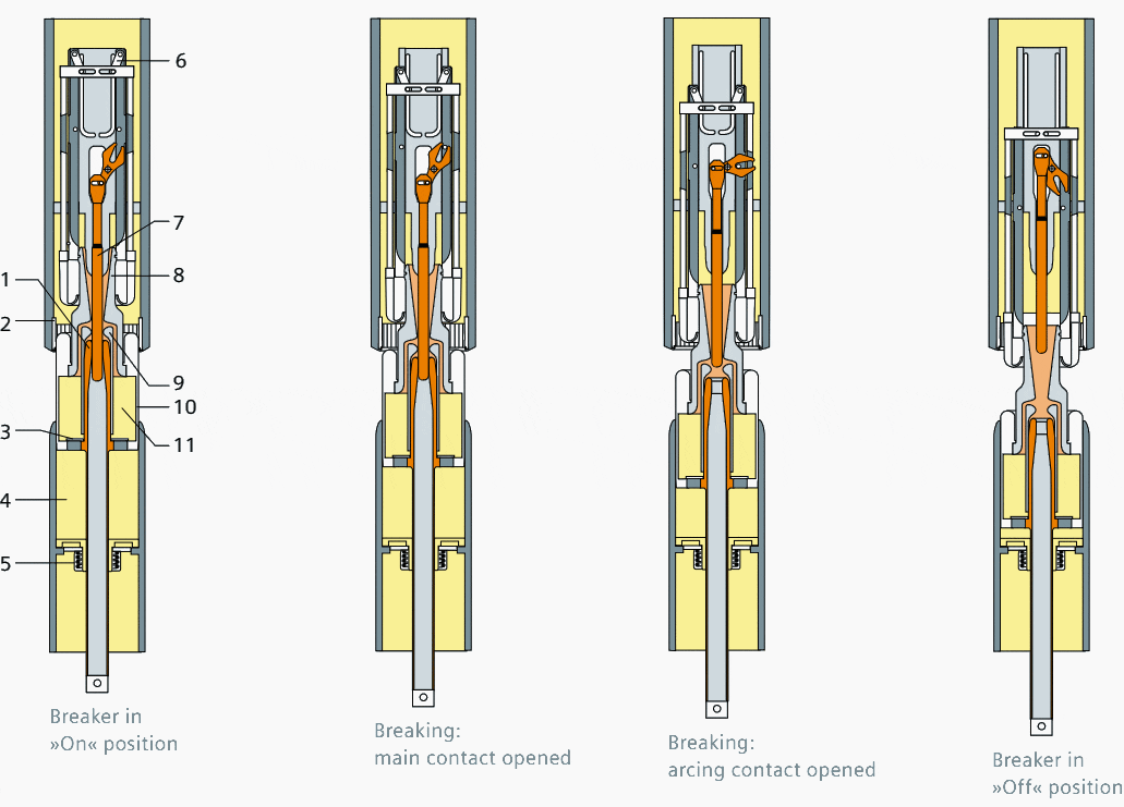

Puffer SF6 circuit breakers are commonly used to accomplish fault current interruption in gas insulated substation systems. In three-phase common modules of circuit breakers, hot gas mix-up is checked to prevent inter-phase short-circuit by electrically conducting hot gas.

Arc-quenching principle
Figure 6 – Arc-quenching principle (The interrupter unit used in the circuit breaker for arc-quenching operates according to the dynamic self-compression principle. This principle requires only little operating energy, which keeps the mechanical stresses on the circuit breaker and its housing as well as the foundation loads to a minimum.)
