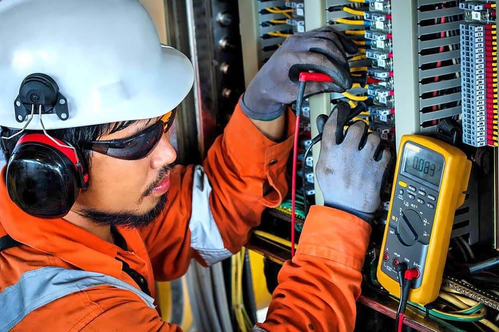

On contrary, preventive troubleshooting is more about finding the actual cause of the occasional malfunctions, niggles, or abnormalities in the system in compliance with the manuals and schematics. This is practiced when the equipment is not broke completely but it might be problematic in near future with some occasional malfunctioning without a specific reason.
Figure 1 – Preventive troubleshooting of an LV panel
