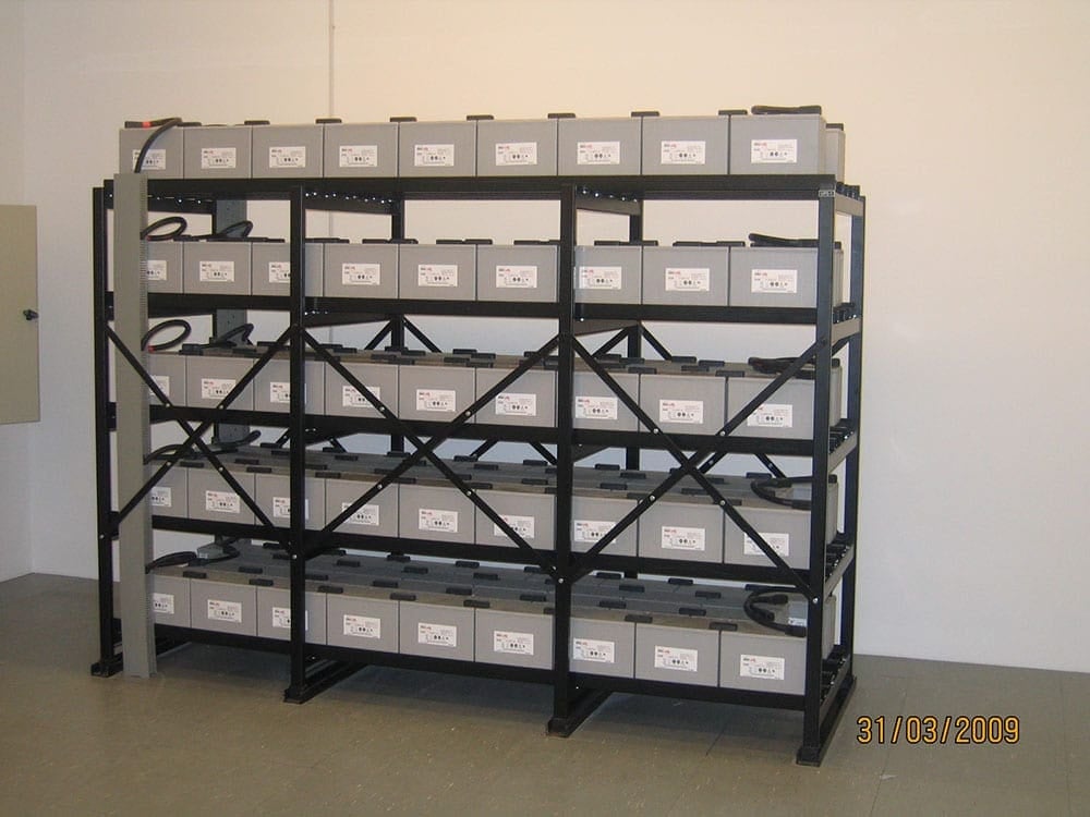

2. Major factors for determining the battery size
The sizing of the battery bank and an overall DC auxiliary power supply system rely upon various factors. Basically, under normal operation, the charger feeds the DC power to the battery to recover the battery voltage after a discharge while also compensating for any self-discharge losses in the battery. The battery charger also feeds any continuous load on the auxiliary DC system, while the battery storage primarily supports the intermittent loads like trip coils, motors, etc.
The battery size calculation assumes the worst-case scenario in which the battery has to drive the continuous and intermittent load both, caused by charger failure.
The duration of charger failure, till it is resumed back, is one of the most important design criteria for calculating the battery size. For instance, the ten-hour rated battery bank should power the entire intermittent and continuous load for at least 10 hours of operating time while maintaining the minimum and maximum acceptable operating voltage of critical equipment.
Apart from the load profile rating, the battery size depends on the discharge characteristics that result in different Amp-hr ratings to feed the same load. The rate at which the battery degrades due to aging also plays a vital role in enhancing the design margin to compensate for capacity and performance degradation. In the case of a lead-acid battery bank, ambient temperature derates the original capacity of the battery.
