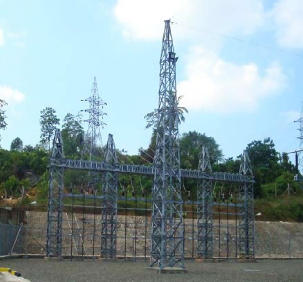

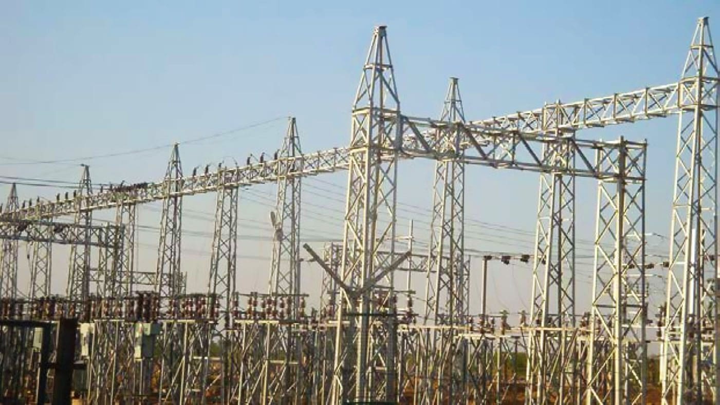

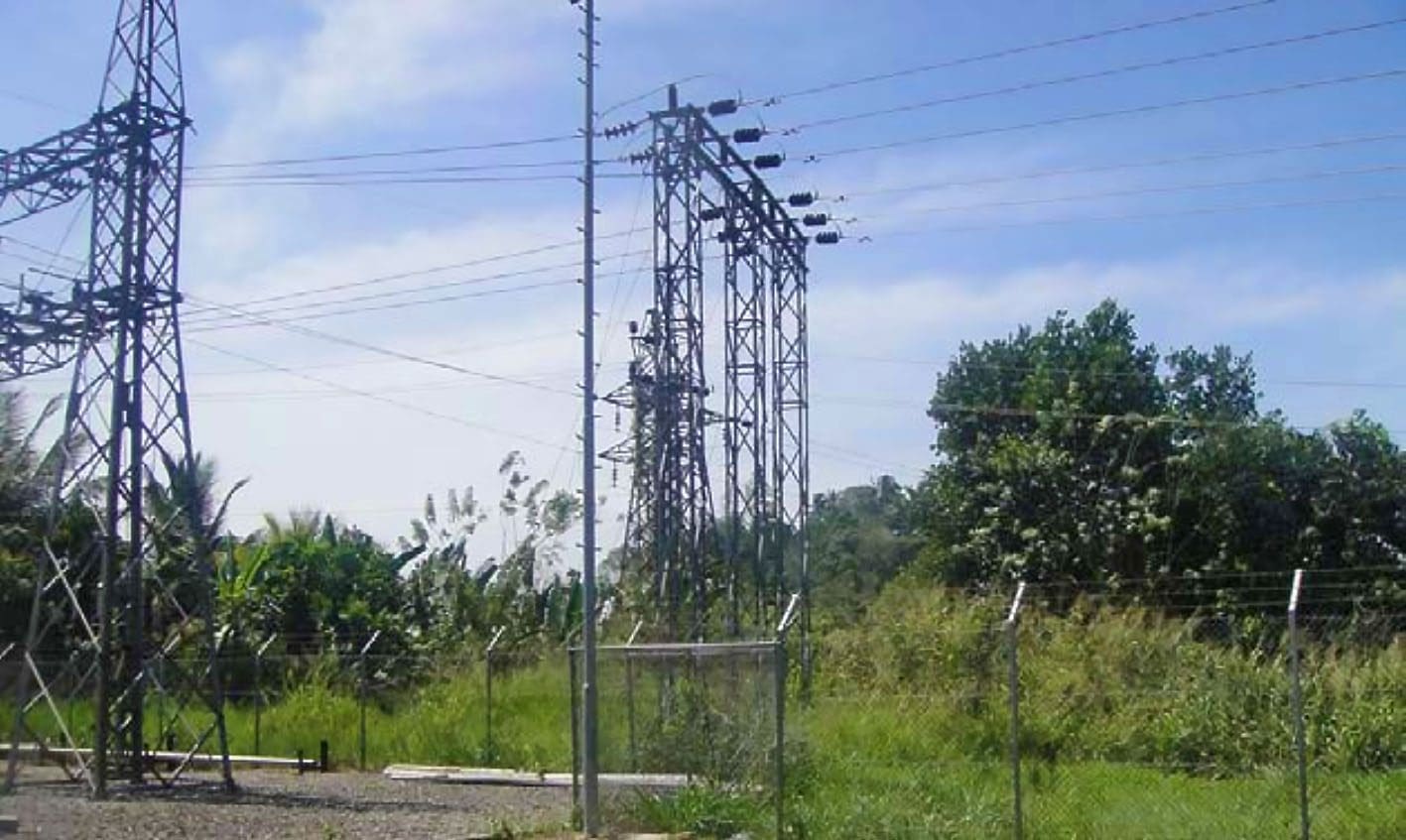

Figure 4 – AIS based substation switchyard equipment station
The AIS substation requires all its components to be situated in the switchyard and air serves as the insulating dielectric medium between different switchgear. Whereas the GIS substations are normally very compact and all equipment are enclosed in Sulphur Hexafluoride (SF6) envelope, a non-toxic greenhouse gas (GHG) used as a dielectric in circuit breakers, switchgear, and other electrical equipment.

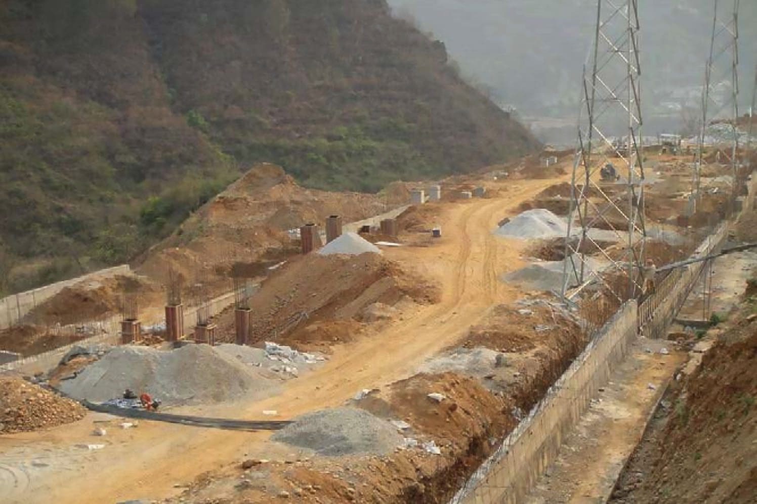

Figure 12 –  Cut and fill of soil for substation land. (blue is current hill profile. Three benches are designed for placement of equipment, transformer, road etc.)
Figure 13 – Benching inside substation land
Figure 14 – Proposed sloping substation land

2.2 Facilities Set Up
2.2.1 Temporary Worker Camps
The worker camps are temporary in nature and will be used until facilities are fully constructed. These camps are normally made at the substation site and the strength of man-power is between 10-20 workers for a maximum of 6-12 months until construction is complete.
Activity causing Impact and Location: Scatter of kitchen waste, toilet waste, wastewater, scrap, unusable/nonrecyclable waste in camps. Poaching of animal life, fishing, harvesting of wood by workers. (Location: Worker Camp)
Impact of activity and its type: Oils, untreated wastewater, sewage etc. flowing into water body, river, drainage areas from the camps causing impact to surface water, ground water, any aquatic life downstream in the area. The downstream water in river can be polluted making it unfit for bathing or potable water.
