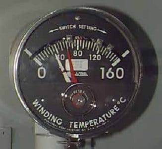

5. Winding Temperature gauge
Gigure 5 – Winding Temperature gauge
Transformers may be furnished with a winding temperature gauge as optional equipment. A temperature sensitive stem is mounted in a leakproof well, permitting removal of both the instrument and stem without lowering the liquid level.
The well is heated by both the surrounding liquid and a heater element which is energized from a current transformer mounted inside the tank to simulate the hot spot winding temperature gradient.
The combination of the two temperatures is indicated on the gauge. An additional red pointer is furnished to show the highest temperature attained since the last reset.
The maximum indicator is resettable by means of a pushbutton through the bottom of the dial bezel .
The gauge has three separate SPDT switches for fan control and alarm circuits. For wiring the contact settings, refer to the schematic furnished with the delivered transformer .
The equipment is calibrated to indicate the hottest spot of the transformer windings. All contacts are factory set to operate at the temperatures shown in the connection diagram. If readjustment of the contacts is desired, consult the manufacturer for detailed instruction.
Go back to Index ↑

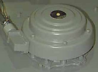

6. Transformer Cooling Fans
Figure 6 – Transformer Cooling Fans
In order to increase the transformer load without overheating the windings, a set of fans can be furnished as an optional item .Fan control consists of a contact on either the liquid temperature gauge or the winding temperature gauge (when furnished), and “Manual-Auto” control switch .
For continuous run, the switch is turned to the “Manual” position. In the “Auto” position, the fans are controlled by the contacts on the temperature gauge. For contact and temperature settings, refer to the schematic furnished with the delivered transformer.
Refer to wiring schematic for control equipment supplied.
Warning! Fan guards are furnished and installed for your protection. Do not remove fan guards or probe into the fan with long objects. Doing so can result in severe personal injury and equipment damage.
Go back to Index ↑

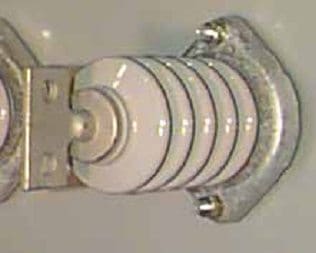

7. High Voltage Bushings
Figure 7 – High Voltage Bushings
High voltage leads for ratings 2 .4 kV and up are normally brought through the tank end wall using a porcelain bushing. To prevent excessive mechanical loading of the bushing, only flexible connections should be made to the bushing terminal.
The bushing should never be used as a structural member to support other current-carrying parts.
Care must be taken in handling the bushing to avoid cracking the porcelain or damaging its surface.
Should it become necessary to replace a bushing or its gasket, proceed as follows:
  1. Vent the tank to the atmosphere until pressure is zero.
  2. Lower the liquid level to a point below the bushing level.
  3. Remove the nuts and washers used to clamp the flange of the bushing.
  4. Pull the bushing outward as far as necessary to replace the gasket and/or to unfasten the cable connection at bushing inner end.
Only in rare circumstances will there be insufficient slack in the cable leads to facilitate bushing replacement through the wall .The alternative means of gaining access to the connections is through the manhole.
When reinstalling the bushing, install a new gasket in the gasket recess on the underside of the flange to insure that the gasket is properly seated in the groove. A flat washer and lock washer should be placed between the mounting nut and the flange. After the nuts are finger tight, each one should be tightened to a torque of 60±5 inch pounds .
After completion, pressure test the transformer. When condenser-type bushings are used, supplementary leaflets forming a part of the complete instruction book will be provided.
Go back to Index ↑
