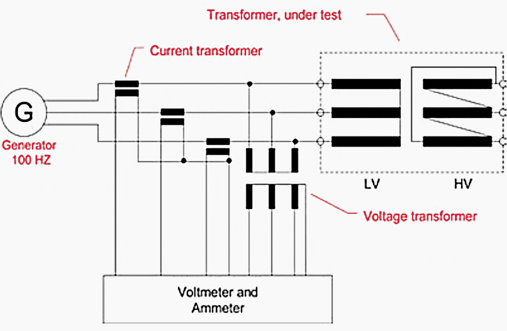

2. Induced voltage test
The test voltage shall be twice the value corresponding to the rated voltage. It shall be applied between the terminals of the secondary windings, by maintaining the primary winding open. The duration of the test at full voltage shall be 60 s, and the frequency twice the rated value.
The test shall start with a voltage lower than 1/3 the full test voltage, and it shall be quickly increased up to full value.
At the end of the test, the voltage shall be rapidly reduced up to 1/3 the rated value before disconnection. The test is successful if no failure occurs at full test voltage.
Figure 2 – Induced voltage test

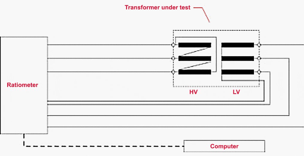

3. Voltage ratio measurement and check of polarity/connections
Voltage ratio measurement and check of polarities and connections shall be performed on all tap changer positions. The correspondence between the numbers assigned to the tappings and the ratings shall also be checked.
Voltage ratio measurement shall be performed phase by phase between the terminals of corresponding windings.
Voltage ratio measurement is carried out by use of potentiometric method.
Figure 3 – Voltage ratio measurement and check of polarity/connections

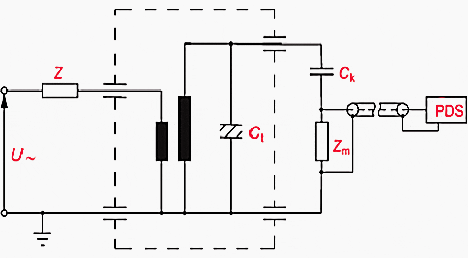

7. Partial discharge measurement
All PD measuring methods are based on the detection of PD current impulses i(t) circulating in the parallel‐connected capacitors Ck (coupling capacitor) and Ct (test object capacitance) via measuring impedance Zm.
The basic equivalent circuit for PD measurements is presented in figure 5.
Test circuit for measurement without capacitive tap
Figure XX – Test circuit for measurement without capacitive tap
Where:
  • PDS = PD system
  • Ck = coupling capacitor
  • Ct = test object capacitance
  • Z = voltage source connection
  • Zm = measuring impedance
The measuring impedance Zm can either be connected in series with coupling capacitor Ck or with the test object capacitance Ct. PD current impulses are generated by charge transfers between parallel‐connected capacitor Ck (coupling capacitor) and Ct (test object capacitance).
Present IEC and IEEE Standards have both established rules for measuring and evaluating electric signals caused by partial discharges together with specifications on permissible magnitude. The IEC approach to the processing of the recorded electric signal is different from the IEEE approach.
IEC transforms the signal to an apparent electric charge generally measured in picocoulombs (pC), while IEEE transforms the signal to a Radio Interference Voltage (RIV), generally measured in micro volts (μV). The use of the RIV‐method for PD‐signal detection will be abandoned, although the IEEE standard has not yet been officially approved.
The detection of apparent charge in pC is the preferred method now in use in IEEE Std. C57.113.
For the detection of apparent charge the integration of the PD‐current impulses i(t) is required.
Integration of the PD current impulses can be performed either in the time domain (digital oscilloscope) or in the frequency domain (band‐pass filter). Most PD systems available on the market perform a “quasi integration” of the PD current impulses in the frequency domain using a “wide‐band” or “narrow‐band” filter.
Circulating PD current impulses – generated by an external PD source (in the test circuit) or by an internal PD source (in the insulating system of the transformer) – can only be measured at the transformer bushings.
Bushing capacitance C1, represents the coupling capacitor Ck, which is connected in parallel with capacitance Ct (test object = total capacitance of the transformer insulating system).
