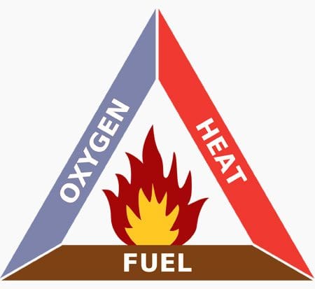

Extinguishment of fires (Fire triangle)
The fire triangle provides a very good graphic presentation of how a fire can be extinguished.
Fire triangle
Fire triangle
Remove the heat
The fire can be extinguished if the heat is removed and the fuel is cooled below its fire point temperature. Water can be very efficient as a cooling medium to extinguish external fires and to protect adjacent asset from being heated to their flash point.
Water is less efficient in extinguishing a fire burning inside a transformer, as it is often difficult to get the water into the transformer tank and the oil will float on the top of the water and continue burning even if water is sprayed in to a transformer tank.
Also for the same reason water alone is not efficient in extinguishing oil pool fires. Whereas water with foam can be very efficient for this purpose as it excluded oxygen from the oil surface.
Oxygen displacement or dilution
Removal of oxygen can be a very effective method of extinguishing fires where this method is possible. Only a slight decrease of the oxygen concentration in air decreases the fire intensity and below 16 % oxygen in the air there is no risk for a fire.
Many alternative gases have been used successfully to displace or dilute oxygen and thus extinguish the transformer fire.
Gases commonly used for this purpose include carbon dioxide, halon and nitrogen. (halon is now disappearing from use, as it is considered a non-environmentally friendly gas).
The disadvantage for all of these gases has been that human beings could be suffocated, if the gas is injected before all humans have been evacuated. CO2 is heavier than air and is often used in buildings and other areas where the gas can be contained and the displaced air can raise above the fire.
Nitrogen is lighter than air and is uses for injection where the fire is at an upper surface and the nitrogen can be contained, as it can in a transformer tank.
Some manufactures of transformer fire extinguishing systems, have used nitrogen for injection into the base of oil filled transformers to extinguishing a fire burning from the oil surface. In this application nitrogen will stir and cool the oil in the transformer tank and displace the air above the oil and suppress the fire.
Foam and high pressure water fogging can also be used to displace oxygen.
Foam can be very effective for use on oil pool fires, but is less effective on oil fires where oil is spilling over a vertical surface and it is often difficult to get foam into a fire burning inside a transformer tank. Water deluge and high pressure water fog or water mist have the benefit of oxygen dilution as well as providing cooling.
